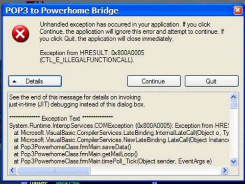

I’m getting an “Unhandled Exception” using Tony’s POP3 Powerhome Bridge”. Anyone seen this?

Interesting failure. Last night another failure occurred and all the info was the same but it blamed .NET Framework. It shows loading email but doesn’t finish. Just hangs… I’ll update when I have better info.

Tony, had another failure. When it occurred it happened on both of my systems at the same time. The systems are similar in software only.
Sometimes it just hangs but this time it threw this error

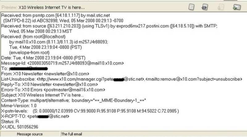

This is the start raw data on the pop3 server. None of this was written to the file but the file was created.

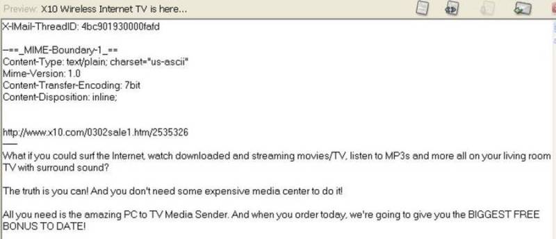

That’s a good point being that most of the hangs are with SPAM type mail. I captured the E-mail and forward to myself but it would not fail. Probably because of the header. The whole thing is 95KB and is totally HTML.
