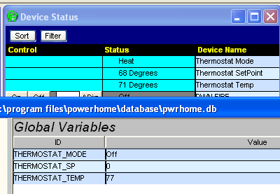

Posted: July 25 2008 at 21:59 | IP Logged Quote GadgetGuy
OK!
Got all SQL imports to work OK and can now control my THERMOSTAT but I cannot get any status from it!
I made sure all of the Global Variables match in name and everything looks OK in the AnalogIO definition, and the macros but my "Device Status" window in PH never changes from Heat Mode, 68d Setpoint, and 71d Temp. Even after running the 'TSTAT_GETTSTAT_GLOBAL' macro, the Device Status never changes.
As the attached screen capture shows, the Global Variables are correct (except for the setpoint) but the Device Status is stuck at some static value.
I've refreshed the window (F5) and re-initialized and even restarted but the Device Status never changes from the above noted, which do NOT match the Thermostat actual values at all.
Ideas?

Posted: July 26 2008 at 00:40 | IP Logged Quote martlist
GadgetGuy,
A couple of ideas. Which of my imports did you use? The original post or the alter single macro from April 20th? Or maybe a combo?
One thought is that the original post used Virtual Devices, the second one used Global Variables and I removed the Vritual Devices.
The TSTAT_GET_GLOBAL only updates the global variables. Could be you have the code to add the vritual device and even the code to update it but maybe you are not calling it?
Can you list what TSTAT* macros you now have so I can see if maybe there is something missing?
If you are getting global variables updated then it must be the macros for Vritual Devices that is missing or failing.

Posted: July 26 2008 at 07:39 | IP Logged Quote GadgetGuy
martlist -
Thanks. I have tried all of the various posts without success, but that said I may well have not cleanly purged the db between efforts. My current config should be clean, but looking back I'm not sure which source it came from. I think your last post, but the easiest way to advise correctly is to send you screen caps and my SQL insert work sheet. Rather than clutter up the Forum with all that, if you send me a Private Message with your email address, I will forward everything directly to you.
Posted: July 26 2008 at 07:47 | IP Logged Quote GadgetGuy
Woops - I forgot to add to the above, that I do have Virtual Devices as I wanted the STAT settings to show up in the Device Status window.
I modified the Virtual Device variables to match the Global Variable names so that (I thought) TSTAT_GET_GLOBAL would update things correctly.
Maybe seeing my SQL Insert worksheet will answer the questions.2008-07-26_074645_STATmacros.txt

The definition for the set is:
--Syntax
ph_setotheranalogout ( controller, type, unit, point,
value )
--Argument Description
controller: The ID of the controller.
type: The type of the Analog Point. Use 0 for inputs, 1
for outputs, 2 for Multi-State, 3 for Temperature, 4 for
Arm Status, and 5 for Alarm State.
unit: The address of the unit.
point: The analog output point you wish to set the
value of.
value: The value you wish to write to the analog
output.
Your strings seem to be missing the third argument.
Whereas your string is:
ph_setotheranalogout("VIRT",0,3,ph_in
steonwithret("THERMOSTAT",106,32) / 2)
Mine is:
ph_setotheranalogout("VIRT",0,0,3,ph_insteonwithret("TH
That is I have an extra "0" before the "3" following the
"VIRT" parameter.
Since my STAT works OK, I think it may be that all of
your analogout efforts are missing a "0" as the third parameter.
Try that and see if it helps.
demko
Joined: January 08 2009
Posts: 15
Posted: January 09 2009 at 22:31 | IP Logged Quote demko
Thanks for the help. I tried it, but it's still not working. Notice anything else?
Back to Top View demko's Profile Search for other posts by demko
Posted: January 10 2009 at 08:53 | IP Logged Quote GadgetGuy
Pat - looking over your posted code again and comparing
it to my original efforts, yours indeed looks OK, which
leads me to suspect you may be experiencing the same
problem I did when I initially tried to enter code (see
my post dated July 26).
Attempting to import the code from the forum, as it
appears you are doing, I found that the forum word-wraps
text strings at arbitrary places and subsequently can
put a space in the middle of a macro function name(which
of course mades it invalid). It was hard to spot
because looking at it in the Macros window of PH, the
word wrap break occurred at the end of the field window
and so looked natural.
Open the PowerHome Explorer and open Macros and then
your 'faulty' macro. Then expand the window to get the
"Send Keys/TTS/Dim/Formula" column as wide as possible.
This will usually cause an inappropriately broken line
to show clearly. Any line breaks in a Macro string can
only happen at a comma or in a text string, but not in
the middle of a ph function name. If you find one,
remove the space.
Hopefully this is your problem.
