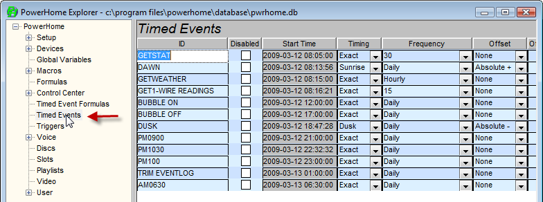

To answer your "get it going" questions, go back to the top of this forum thread and scroll down to the section titled "FINALLY TO GET IT ALL GOING."
The STAT readings are gathered by the GETSTAT macro which in turn is called on a timed basis by a Timed Event (accessed via the PowerHome Explorer) also called GETSTAT. [See red arrow]
I have my timed event set to fire off automatically every 30 minutes, which seems about right since house temperature doesn't normally change very rapidly.
To test things out you can also right click on your GETSTAT Macro itself (in the PH Explorer window) and select "Play" This will fire it off, just as the Timed Event call would have. This will let you test things without having to keep changing the Timed Event trigger times.
