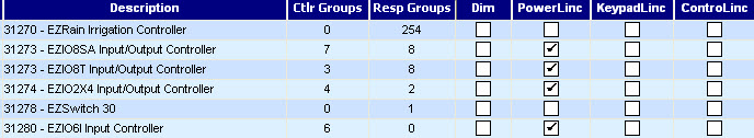

My Type entry for the EZIO8SA does not have the PowerLinc column checked and the DB type is Linear.  Although the EZIO8SA is using a PLM that could be used as a PowerLinc interface, the PLM is not being used in that capacity when connected to the EZIO8SA .  SHN had to use an external PLM (rather than the internal PLM it uses in its other devices) because the number of Inputs and Output Relays would not fit inside the shell of an Insteon device.  I suspect that with the PowerLinc column checked, PH2 is not sending normal Peek/Poke commands to the device as that would not work if the PLM was really being used as a PowerLinc interface.  Uncheck the PowerLinc column and the DB column will probably be changed automatically.  If not set it to Linear.   Do a ReInit or restart after changing the Type entry.
 The log file shows no Insteon command activity which is consistent with a PowerLinc definition.  PH2 would use the programmatic serial/USB interface to add link records to a PowerLinc device.  That does not work since the PLM is actually connected to the EZIO8SA rather than the host PC.
 Don’t know what PH2 does when the basic type of device is changed.  Not sure but you may have to click on Rebuild after selecting the EZIO8SA Device entry after changing the Type entry and doing a Reinit/restart.
 You should see Insteon message traffic in the Insteon Raw Log window as well as in the log file.  The log file can get pretty big over time so you may want to uncheck the Echo Raw Log to File option once it has been established that PH2 is writing link records to the EZIO8SA.  You can leave the path definition in the Settings as that has no effect if the Echo option is not checked.

No problem changing the DB Type to Linear. But when I try to uncheck the EZIO8SA Powerlinc column I get the following "Critical Error":

 After a Save/Reinit or Restart the Powerlinc column is back Checked again.
 Tried deleting the EZIO8SA device, experienced the same result.
 Odd that several of my EZIO Types are checked as "Powerlinc". I have no recollection of ever touching the settings....

I created my own Type entry for an EZIO8SA with a large PLM.  Did it that way so I could still use the original EZIO8SA Type definition if using a small memory PLM.  I tried unchecking the original EZIO8SA Type and get the same error you are seeing.  I take that to be a bug with PH2.  Guess it is just as well I did not try using the original EZIO8SA Type definition with a small memory PLM or I would have run into the same problem you have been seeing.
 Create a new Type entry that looks like the original EZIO8SA except set the memory size to the larger value and do not check the PowerLinc column.  Back in PH1 there were no predefined Type entries for the SimpleHomeNet products so I had to create Type entries for all the SHN devices I have installed.  You will probably have to reinit/restart after defining the new Type before you can change the EZIO8SA Device entry to the new Type definition.  I would reinit/restart after changing the EZIO8SA Device entry just to be sure the change is in effect.

Ta Da! That did it - I can create links now. Thanks a million Lee & Pete. Couldn't have figured all that out without your help.
