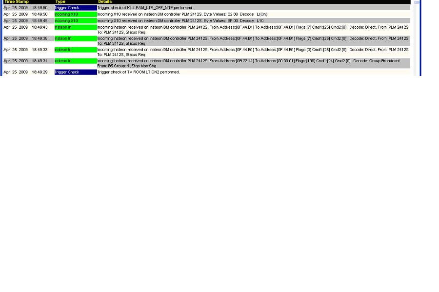

Well, it finally happened again. The PLM tried to communicate with itself and redded out. The event log shows that an insteon device (an icon dimmer switch)sent out a broadcast to "Stop Man Chg." Then the PLM tried to send itself three status requests. Here is the event log and raw log.

I doubt it has anything to do with the trigger (TV ROOM LT ON2) because it fires all the time and is set to turn off a light in a room late at night using X10.
The device "B5" is suspect. I noticed recently that the little amber led flashes whenever there is insteon traffic on the powerline, the same way the led on a PLC or PLM would flash. The device is linked with one other icon dimmer and they control five LV halogen can lights. The switch's operation has been practically flawless for three years, other than the flashing LED which is a pretty recent development. I have had other switches that have had their LEDs flash in response to network traffic. Usually rebuilding the links has taken care of it, although I can't say I have been aggressive about it since I considered it odd, but not a problem. Thoughts?
Oh, I almost forgot. PH was polling at the time. I rebooted and forgot to uncheck status scan.

There was an X10 L10 ON received at 18:49:29 which looks like it caused trigger TV ROOM LT ON2 to fire.
That was followed at 18:49:31 by a Group Broadcast from 0B.23.41 (B5) Group 1 Stop Dim/Bright which was in the Raw Log and the Event Log. Someone was doing a manual Dim or Bright and released the switch which results in the Stop Dim/Bright command 0x18 (dec 24).
There three Status Requests, to 0B.23.41, 03.B6.01, 0D.4E.66 which are not in the Event Log which should indicate they are part of the background Status Scan operation.
Then there is a Status Request at 18:49:33 checking the status of the PLM. This is a bad command and since it is in the Event Log Powerhome thinks this came from a foreground activity, not the background Status Scan. The last trigger to fire was TV ROOM LT ON2 which suggests the PLM Status request came from something this trigger did. Can you post this trigger? Since there were three Status checks that also ran in the background perhaps something the trigger relies on to determine what device(s) it will communicate with was affected by the background Status Scan operation.
I am looking at only a snip it of the Raw Log and the Event Log so there could be something earlier that actually generated the PLM Status request that I cannot see. The fact that the activity is in the Event Log suggests it came from something you implemented rather than being part of the background Status Scan.

Lee, what does “stop Man Chg” do and since it’s incoming who did it?
| Posted: April 26 2009 at 10:45 | IP Logged
Pete, a light is Off, you press the On paddle/button and hold it. Because the paddle/button is held On a command 0x17 Start Man Chg is issued that starts the ramping up of the responder. When the desired Bright level is reached, the paddle/button is released and the 0x18 Stop Man Chg command is issued. Same sequence of commands is issued if the light is On except the responder starts to Dim, stopping when the paddle/button is released.
In this case the command came from 0B.23.41 which the Event Log identified as device ID "B5" Group 1. This could be an ICON switch or button 1 of a KeypadLinc.

The Insteon device "B5" is an icon dimmer ver 1.6. Ver 1.2 was the one where Smarthome had a lot of paddle issues. I have many of the ver 1.6 icons and none of the LEDs flash with Insteon communications except this one (and there is nothing in the manuals explaining that it should flash). I do have one Switchlinc V2 dimmer that has also had this behavior in the past. The switch (B5) is paired/linked with one other switch and they communicate perfectly (i.e., the links are verified and they operate normally). Also, the flashing is happening with ANY network communications, not just the comms to/from that device.
I specifically recall setting the dim setting on that icon switch because it was at our kitchen table for dinner. So, yes, Lee, you are spot on.
As for the trigger "TV ROOM LT ON2" is very basic: if motion is detected by L10 (a wireless X10 motion sensor -MS14 I believe) and an L10 ON signal is picked up by PH, then the trigger sends out an X10 command (C9 ON) to an RR501 receiver which turns on a living room light. The trigger fires every time motion is detected in the living room, but only sends the ON command (C9) between 11:30 pm and DUSK.
I don't understand what you guys mean by "dual addressing." Nothing I have set up has the same X10 address. I have 30 insteon devices and 2 RR501 transceivers (for activating table lamps addressed at C1 and C9) and 8 wireless X10 motion sensors (addresses of L2/L4/L6/L8/L10/L12/L14). I also have 2 DS10A X-10 wireless magnetic contact sensors (addresses of D1 and D2). I hope this helps. Here is the rest of the raw log, preceding the three PLM self-requests:

2009-04-25 18:50:03.890 RX &nbs p; SENTINSTEON=0F 44 B1 03 5D 09 05 2B 22 06
2009-04-25 18:50:04.093 RX &nbs p; RECEIVEINSTEONRAW=03 5D 09 0F 44 B1 21 2B 21
2009-04-25 18:50:04.218 TX &nbs p; 02 62 03 5D 09 05 2B 32
2009-04-25 18:50:04.250 RX &nbs p; SENTINSTEON=0F 44 B1 03 5D 09 05 2B 32 06
2009-04-25 18:50:04.718 RX &nbs p; RECEIVEINSTEONRAW=03 5D 09 0F 44 B1 26 2B FE

Lee, I don’t know if we had the conversation with Handman BUT how was the PLM loaded? Was it Min or Full? Just a long shot but trying to eliminate problems we’ve seen in the past.
Dual addressing I was referring to is an Insteon device with both an X10 address and an Insteon address. I’m assuming from a previous post there is no links defined between the PLC Elk and PH PLM.
The trace looks like a flood of X10 devices that are not defined by PH. Is that true without me having to pullout by conversion charts?

I get this eerie feeling Lee is acting like a mad scientist and about to come up with a possible answer that indicates he found a bug in PH unless he’s out on the lake. I don’t see the obvious yet but I’m about to tackle your last trace.
| Posted: April 26 2009 at 16:39 | IP Logged
Yayyy!! A bug was found . When the device issued a Stop Manual Change command, PH searched through the link database for every device linked as a responder to the device (in this case, Im assuming the PLM was linked as a responder as most people would) and would have issued a Status request to every device to now determine its new level based upon the manual change. This is what is causing the PLM to get redded out and I will add a change to the code to keep the status requests from going to the controller PLC/PLM. Nice detective work and a good catch.
Concerning the changing of your ID's...unfortunately no. PowerHome will automatically update dependant children (the links, etc.) but Macros and triggers are not in this hierarchy and will not be updated. There is a tool in PH to help make it easier to update though. Under the "Reports" menu is a report called "Database where used". Launching this report will open a window allowing you to type a search string to determine everywhere in the database that the string is used. You'll definately want to use wildcard characters to catch ALL occurences. So if you wanted to find every occurrence of "E5" in the database, just type:
