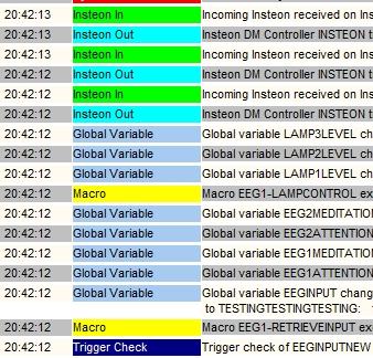

Is there a way to turn off the confirmation signal [shows up in log as Insteon In] from my LampLinc modules upon receiving an Insteon On command?
I was able to get my C code working properly to have both of the EEGs connected to my PC. However, the sequence of the trigger firing (using phfilemon), setting the global variables, and then sending the commands is taking too long. (It was handling it fast enough with just the 1 EEG).

The Insteon In is the ACK to the command issued to the LampLinc. It is integral to the reliability of Insteon command processing and cannot be suppressed.   Instead of issuing a Direct command to turn the LampLinc ON/OFF you can link the PLM as a Controller to the LampLinc as a Responder.   Define a PLC/PLM Group and issue a ph_insteongroup() suppressing the Group Cleanup. The result will be a Group Broadcast being sent to the LampLinc which is not ACKed. The problem with this approach is there is no ACK so if the LampLinc does not receive the command due to some interference no command retry will be done.

I forgot to include in the screenshot that the On level is changing dynamically for each of the lights. That works fine with the Insteon Direct On, but for Insteon Group On cmd2 is not available to send a level.
I am using a value from the EEG (which is outputted every second, to control the brightness of individual lamps so the possibility is that each lamps brightness level could change for every reading.

You cannot do what you want. If there is not enough time for the LampLinc command ACK, there is not time for the 3 commands plus their ACK's to change a link record bright level.
To suppress the Group Cleanup simply add 2000 to the cmd1 value. 2017 would be an ON command with the Group Cleanup suppressed.

Thanks for the explanation. I think I will be able to compensate for the LampLinc command ACKs by cleaning up my code and processes.
So far by handling the brightness levels within my C program and by not updating as many Global Variables I have it working properly for 2 lights. My goal is 3. I added a 0.1 second pause within my C code that is giving enough time for the Insteon commands to process before the next trigger is sent.
I'm looking into switching from using the file monitor plugin to sending socket commands from my c code to add a little more speed. I found a few source code examples I'm gonna look at later on in the week.
