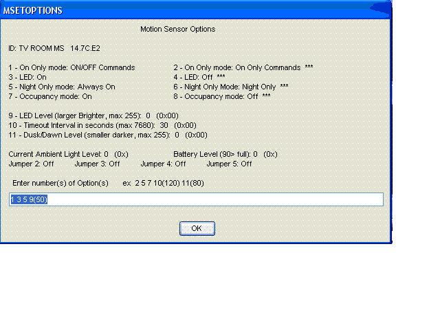

The problem, as you noted Pete, was that I had already saved a macro by the same name and so the script was trying to duplicate the same name. OK. The macro is saved correctly and now I see that I just need to set Trigger ID 3 for the low battery. Thank you, I'll do that.
I ran the macro and Lee's motion sensor setting page came up. THANK YOU!

I personally found it to be informative and self-explanatory when you ran it. It is basically a development tool to assist one in understanding the extended capability of the motion sensor. Lee did a good job of developing it to assist in understanding what the device was up to. Just follow his instructions and your questions will be answered.

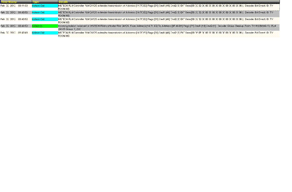

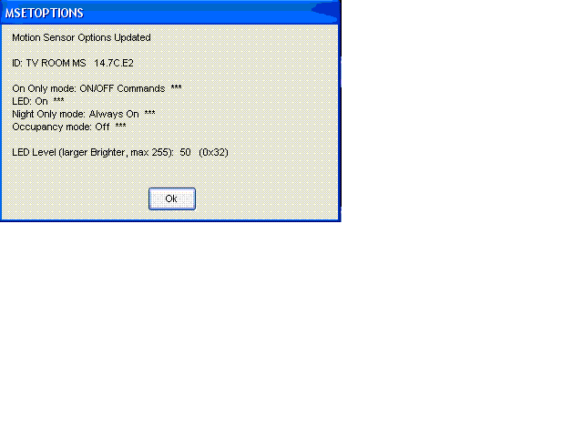

OK, well, that didn't last long. I set the MS to occupancy mode and within 24 hours I was getting low battery warnings. I figured this was a battery drain so I ran Lee's macro to change the settings. A few days later with a new battery, I noticed my MS started misbehaving. I activated Lee's macro again to see what was up and noticed that all the settings I had redone were now at some new settings - some I'd set, some I hadn't. I reran the macro and the script always tells me that the new settings are in place, but if I run the script again, the old (incorrect) settings are there! So, I have a few questions: (1)Does the pop-up which reports that the new settings are programmed just report what was supposed to have happened, or does it actually receive some sort of Insteon confirmation from the motion sensor that the settings were actually changed? (2) Does it matter if jumper 5 (read/write) is left on, or should it be "unjumped" after making the changes, assuming the changes have happened? (3) How many outgoing commands does PH send to change the variables in the motion sensor? My event log shows several Insteon Out commands with Ext DATA, but I never see an Insteon In received with Ext DATA. Maybe my motion sensor is being read, but not written by the script? Any thoughts? Screen shots of event log included.
Edited by Handman - February 02 2012 at 13:41

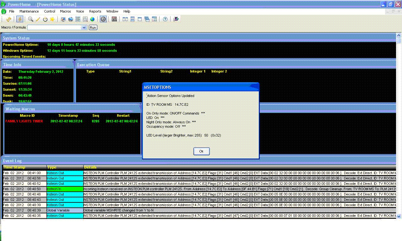

There is a bug in 2.1.4 that is not returning Extended data. That is why you do not see the motion sensor configuration being retrieved with Extended commands.
The final popup reflects what was changed. It does not reflect an additional retrieval of configuration data after the changes are applied. Invoking the macro again without changing anything should show the new values.
Leave Jumper 5 On.
For the battery to drain in a few days it sounds like I have a bug in the macro. There is a command that prevents the motion sensor from turning off the RF circuitry. There should be a follow-up command at the end to allow the motion sensor to go back to normal mode of turning the RF off. I'll check the macro and post back.

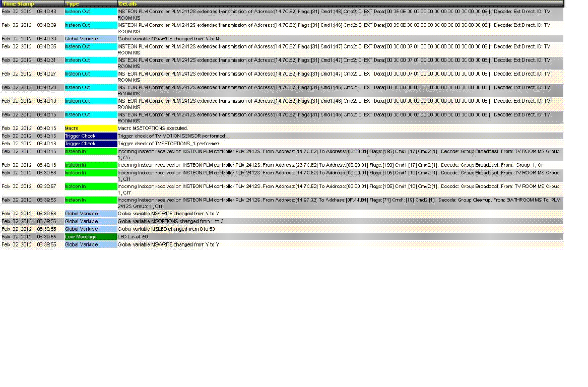

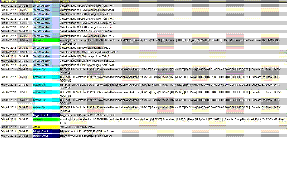

OK, so what seems to be happening is that the popup says the values were changed, but if I run the script again, the values haven't changed. How many times will the Insteon Out command be sent by PH? There are usually a half dozen . . . is that due to the bug in PH or is that because no Insteon In command is received by PH even though it is received? Is it possible that the global variable for MSWRITE changes from a Y back to an N before the changed values are actually received by the motion sensor? Finally, what I see in my motion sensor is actually different than what is showing when the script is first run. E.g., options 2,4,6 and 8 are starred (***), but these are not accurate. My MS is sending OFF commands, the LED is ON, and it seems to be working in daylight conditions. Furthermore, the LED light level shows "0," but I can see it plainly (I try to set it at 50); the current ambient light level shows "0", but it is in a room with daylight; the battery level also shows "0," but this is a one day old battery and the unit appears to trigger with motion most of the time. Also, the jumper status shows OFF for 2-5, but the jumper is ON for #5. As for whether there may be a bug in the macro keeping the RF alive, keep in mind that this is the battery that came with the motion sensor, although it was received from Smarthome a week ago. I never checked the voltage before installing it. When I pulled it two days ago though, the voltage was still decent at 8.5V with no load on it. More screenshots of script attached with a before and after . . . note that the after is the original popup after supposedly changing the settings.
Edited by Handman - February 02 2012 at 13:40
| Posted: February 02 2012 at 13:47 | IP Logged
Post the Insteon Raw Log file from first MS On that triggers the macro and displays the current MS configuration through the second MS On that writes the updates. I do not see a missing command to restore normal RF operation that I initially assumed was the bug. The trace will document what commands are being issued and whether they are successful.

2012-02-02 16:00:08.250 RX &nbs p; RECEIVEINSTEONRAW=13 F2 57 0F 44 DC 41 11 01
2012-02-02 16:00:08.421 TX &nbs p; 02 62 13 F2 57 1F 2E 00 00 00 00 &nbs p;
2012-02-02 16:00:08.484 RX &nbs p; SENTINSTEONEXT=0F 44 DC 13 F2 57 1F 2E 00 00 00 00 00 00 00 00 00 00 00 00 00 00 00 06
2012-02-02 16:00:09.046 RX &nbs p; RECEIVEINSTEONRAW=13 F2 57 0F 44 DC 27 2E 00
2012-02-02 16:00:09.343 RX &nbs p; RECEIVEINSTEONEXT=13 F2 57 0F 44 DC 17 2E 00 00 01 64 00 80 0A 00 86 0E 01 00 53 00 00
2012-02-02 16:00:10.156 TX &nbs p; 02 62 13 F2 57 1F 2F 00 00 00 00 07 01
2012-02-02 16:00:10.890 RX &nbs p; SENTINSTEONEXT=0F 44 DC 13 F2 57 1F 2F 00 00 00 00 07 01 00 00 00 00 00 00 00 00 00 06
2012-02-02 16:00:10.906 RX &nbs p; RECEIVEINSTEONRAW=13 F2 57 0F 44 DC 27 2F 00
2012-02-02 16:00:11.125 RX &nbs p; RECEIVEINSTEONEXT=13 F2 57 0F 44 DC 11 2F 00 00 01 00 07 01 50 10 01 34 0A 64 00 80 00
2012-02-02 16:00:11.187 TX &nbs p; 02 62 13 F2 57 0F 20 18
2012-02-02 16:00:11.234 RX &nbs p; SENTINSTEON=0F 44 DC 13 F2 57 0F 20 18 06
2012-02-02 16:00:11.828 RX &nbs p; RECEIVEINSTEONRAW=13 F2 57 0F 44 DC 27 20 18
2012-02-02 16:00:12.078 TX &nbs p; 02 62 13 F2 57 1F 2E 00 00 05 0E &nbs p;
2012-02-02 16:00:12.125 RX &nbs p; SENTINSTEONEXT=0F 44 DC 13 F2 57 1F 2E 00 00 05 0E 00 00 00 00 00 00 00 00 00 00 00 06
2012-02-02 16:00:12.703 RX &nbs p; RECEIVEINSTEONRAW=13 F2 57 0F 44 DC 27 2E 00
2012-02-02 16:00:12.812 TX &nbs p; 02 62 13 F2 57 1F 2E 00 00 02 20 &nbs p;
2012-02-02 16:00:12.968 RX &nbs p; SENTINSTEONEXT=0F 44 DC 13 F2 57 1F 2E 00 00 02 20 00 00 00 00 00 00 00 00 00 00 00 06
2012-02-02 16:00:13.890 RX &nbs p; RECEIVEINSTEONRAW=13 F2 57 0F 44 DC 27 2E 00
2012-02-02 16:00:14.000 TX &nbs p; 02 62 13 F2 57 0F 20 19
2012-02-02 16:00:14.140 RX &nbs p; SENTINSTEON=0F 44 DC 13 F2 57 0F 20 19 06
2012-02-02 16:00:14.421 RX &nbs p; RECEIVEINSTEONRAW=13 F2 57 0F 44 DC 27 20 19
Perhaps moving the motion sensor and access point closer to the PLM.
