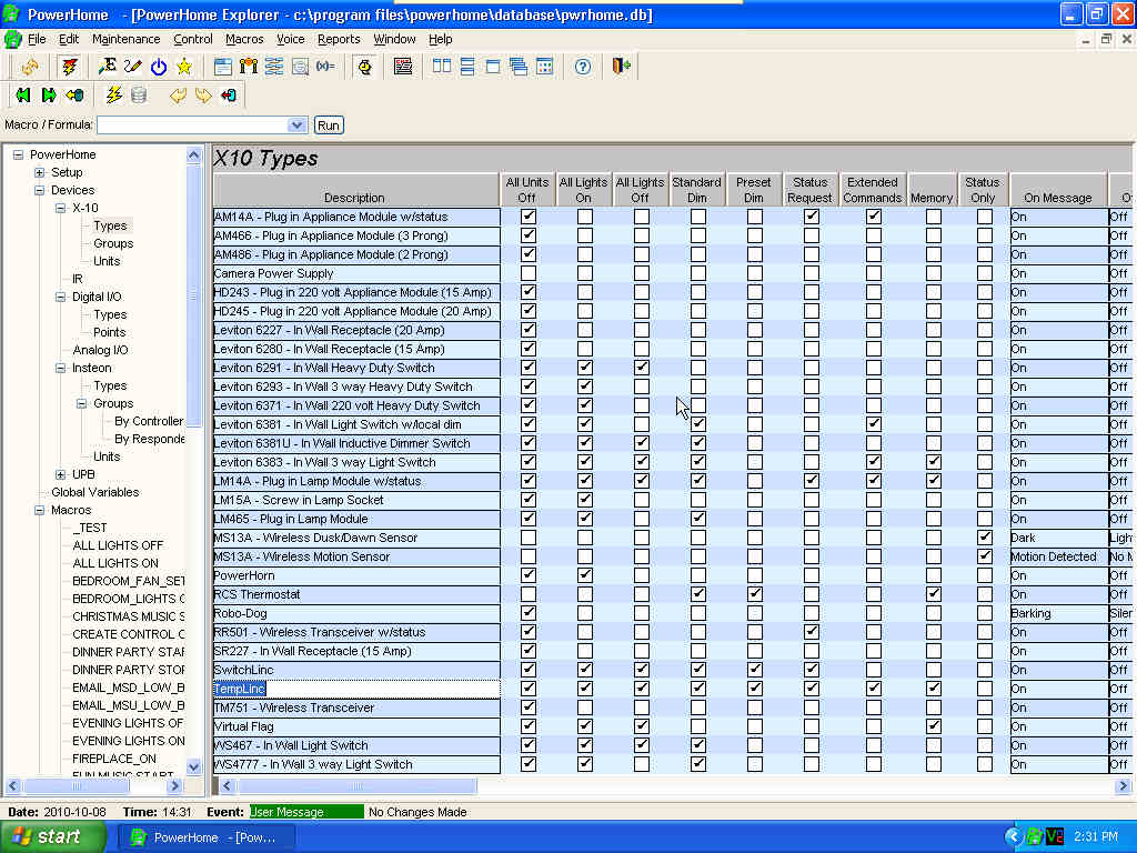

You know...while I wait for my fresh batch of ice to do the trick (the thermo-sensor was at room temp or a little warmer)...something about the way I have the TempLinc device configured in the X-10 devices section makes me want to run it by you guys....the screen capture is attached (everything out to the right is default for a new device - it's the check-boxes I wanted to verify).

What it doesn’t support won’t hurt. This table is kind of a features support for programming. The only thing I’ve read about this beast is it will take 16 unit codes and multiplies that out into the number of sequences. The reason why I had you switch to on and offs was to verify the powerline was seeing the PLC output.

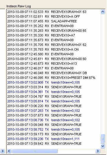

Huh. It's getting weird. I was beginning to wonder if the device is getting the commands....So I plugged it directly into the PLM, and issued the initialize (3x A6 code) command, plus the program (2x A1), and then a Status Request (X-10 Direct)...
Now, the problem is that my Powerhome Server is in a rack in the basement, where the PLM is plugged, so I unplug the TempLinc, put it in my pocket, went down there did something else (a little cleaning, removal of the old (dead) fan, etc. Then I plugged in the TempLinc and rushed upstairs to my workstation so I could execute the above commands...which I did.
In the mean time I look back in the logs and just before I issued the new commands (and based on my "counting while running" right about the time I plugged the TempLinc in) there are X10 RAW receive commands...which based on the TempLinc manual, could very well be legitimate because when it re-powers up, it may send new information if there is a need....however, I have seen nothing since, and because the basement is definitely a different temperature, I would expect to see something...so now I'm perplexed.
It is definitely NOT responding to a status request...
Holy UNDERWEAR, Batman....!
Below is my Insteon RAW Log:
Edited by syonker - October 09 2010 at 09:22

| Posted: October 09 2010 at 09:38 | IP Logged
Here’s your sequence:
A7
ON
A13
DIM
A6
A6
A6
A1
A1
A6
STATUS REQ.
Why the double A1s and where did the Status Request come from. At the top the ON is invalid for that device if I read the manual right. Do you have a desktop X10 controller you can manually do this with?
| Posted: October 09 2010 at 09:55 | IP Logged
Looking at this further it looks like it sent back a temperature of 31 if that’s the case it is in the wrong mode but working.
| Posted: October 09 2010 at 11:31 | IP Logged
I would remove the second A1. The Preset Dim 87% happened about 15 seconds before the A6 programming sequence was issued. Does make one wonder if that was generated when the TempLinc was plugged in.
