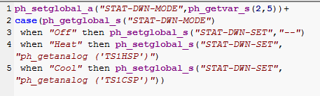

I cannot get my Thermostat changes in 2.1.5a to Trigger
properly.
This formula keeps getting flagged as an error, yet every
single one of the commands therein individually work.
I have been fighting this for hours.
Anyone have any suggestions?
| Posted: July 17 2014 at 19:32 | IP Logged
Ken,
I think your problem is probably in the
ph_setglobal_s("STAT-DWN-SET","ph_getanalog('TS1HSP')")
and ph_setglobal_s("STAT-DWN-
SET","ph_getanalog('TS1CSP')") statements.
The ph_getanalog function will never execute as its
enclosed in double quotes making it a string. I would
remove the double quotes from around the ph_getanalog
functions since they both return a string and thats what
the 2nd parameter of ph_setglobal_s expects.
| Posted: July 18 2014 at 06:16 | IP Logged
You are correct Dave. My bad for not posting that myself,
in the Forum. Later debugging, looking at the Event Log
error postings, showed that I was getting a string, rather
than an executable function.
All is well now.
