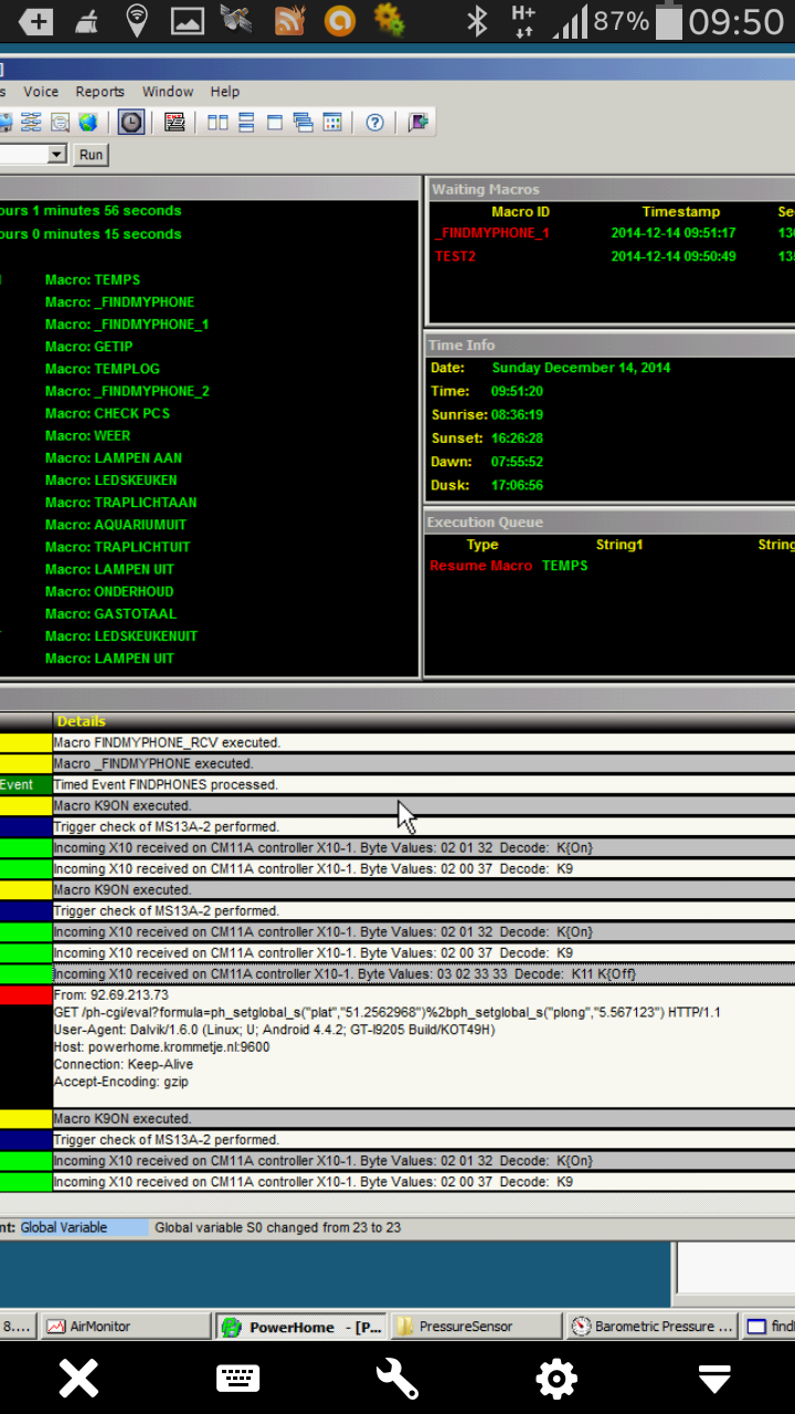

Here is a screenshot of the log:
I still think this is an auth. problem however can't think what to do next: IP's whitelisted and auth set to basic...
Back to Top View krommetje's Profile Search for other posts by krommetje Visit krommetje's Homepage
Posted: December 15 2014 at 16:35 | IP Logged Quote dhoward
Peter,
Very sorry to hear about your family. Its terrible anytime but even more so this time of year.
Looking at your screenshot, the request doesnt have an "Authorization: Basic" section that would normally be included if you had supplied credentials on the URL line. This would put the issue with whatever http client you're using to access PowerHome with. If you compare this log entry to one that works, you should see the difference.
However, you say that you've got the IP in the trusted IP section of the webserver configuration. If you could send a screenshot of the Trusted IP section or just copy/paste the data there I can verify that its formatted properly. With 92.69.213.73 set as trusted, you shouldnt need to include any authorization and it should just work.
