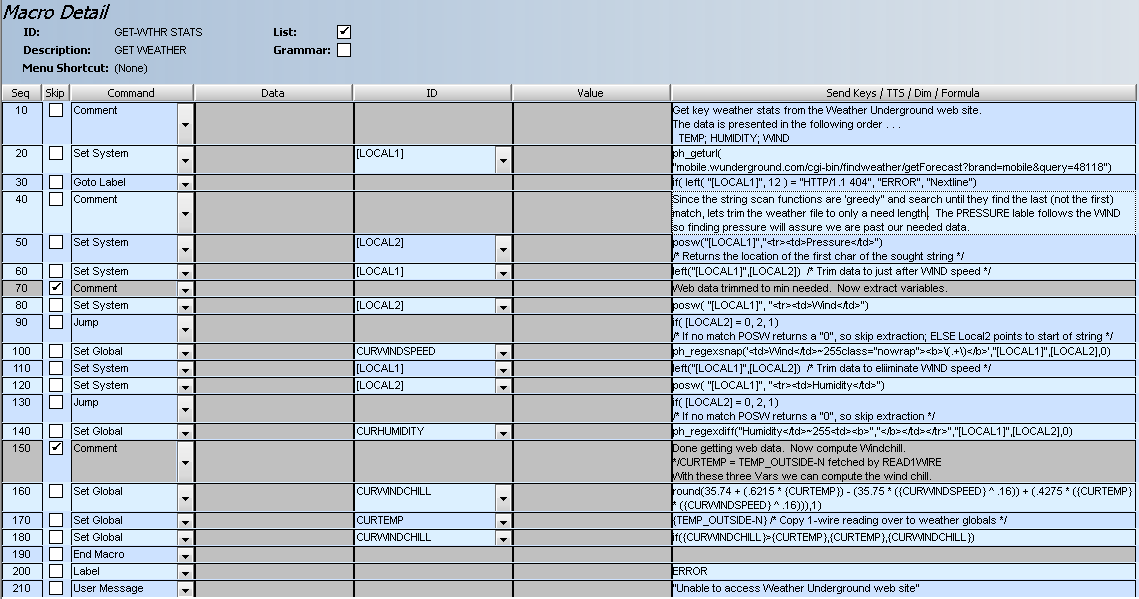

In a more human readable form, this looks like . . .

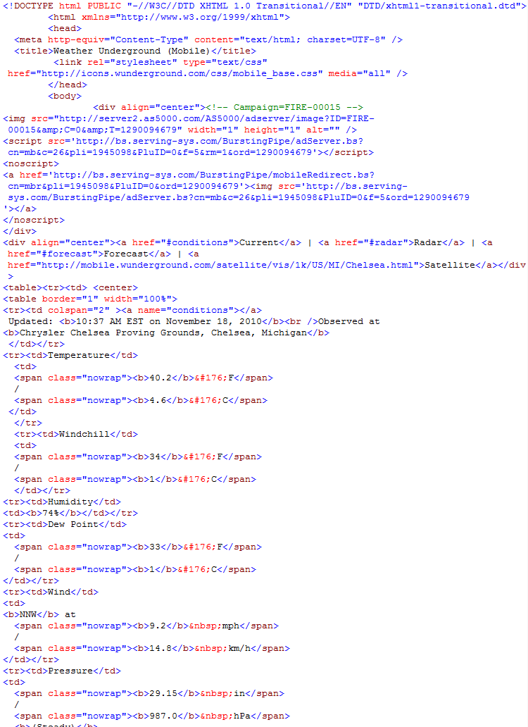

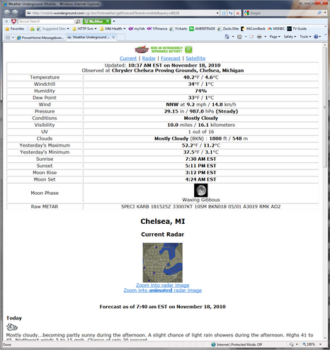

To correlate the code with the target web page, here is a snapshot of the weather page . . .
And here is the HTML Source Code for that image . . .
