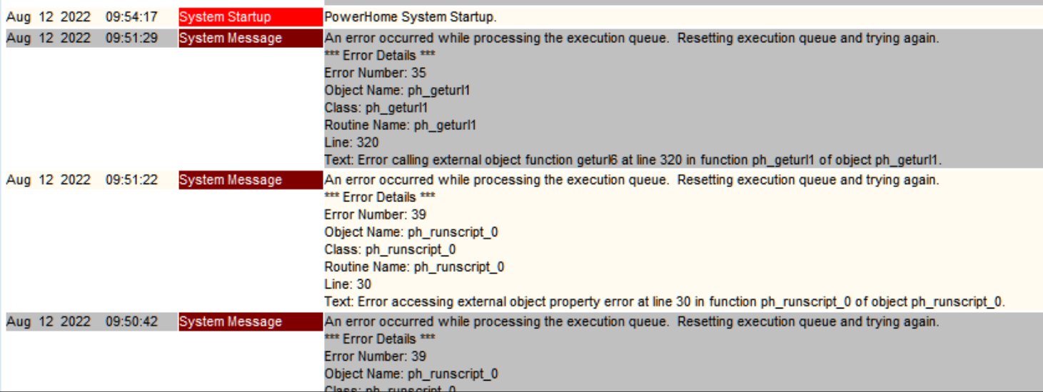

I may have accidentally captured something related to this topic. I was doing some network changes, and I unplugged my
network from the PH server. During that time, I noticed PH had disappeared. I reconnected the network, and restarted PH.
Sometime during that process I got 32 of these messages seemingly from several macros.
Looks interesting.
Here's part of the log:
This was the very first error:
I'm just sharing what I might have captured.

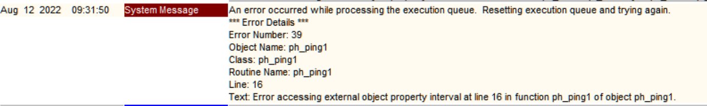

Seems that this might be a real "thing" for Dave to investigate, but I know this will be almost impossible to find. When I was adjusting my network, I got "Execution
Queue" issues as I identified above (sorry for the jumbo size picture). I would assume that's a pretty critical problem and outside what I can test/fix.
