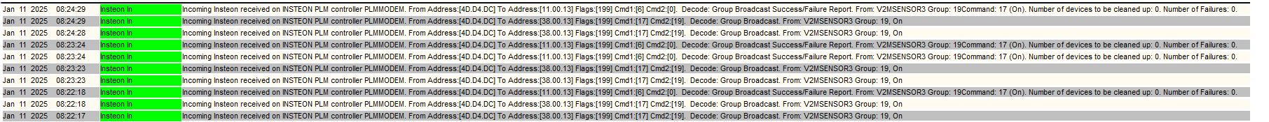

Hi - A month or so ago, I mounted a V2 motion sensor outside. It
worked really well, sending Group 1 on/off when (and only when)
there was real motion detected. However, I came to discover that it
almost continually sends out Group 19 On signals, in bursts of 5 to
20, sometimes only 15 seconds apart, sometimes minutes apart
Resetting the sensor made no difference. Yesterday I replaced the
sensor with a different brand new one, and it does the exact same
thing.   The strange thing is that even though the units are hard-
reset and then linked only to my PLM (11.CC.FF), the Group 19
commands are directed to addresses I do not recognize ([xx.00.13]
where xx changes (could be 4B, 4C, 11,39, 38, 3A), and both
sensors sent to the same bogus addresses. Also, looking at the
log, there seem to be "noisy" period when it's sending them
frequently, and some "quiet" hours where it sends nothing, but I
can't find any pattern.
Oddly, I have a 3rd V2 sensor mounted indoors and it doesn't do
this.
Anyway, I'm wondering if anyone has an idea why the sensor would
send these cascades of Group 19 On? (and more important, how
to quiet it) What is Group 19 anyway? :-)
TIA for any ideas - thanks!
Log snippet attached:
Thanks!
