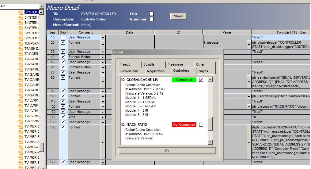

By looking at the logs after a re-start, it appears that this occurs when I have a trigger that fires when my Itach controller goes offline (CONTROLLER STAT1). My Itach controller is a Wi-Fi to IR unit. Recall that there were recent changes to PH to make the Itach controller restart more robust. Maybe my re-start macro is trampling something? My Wi-Fi is decently stable, but I see this issue about once every 2-3 days.

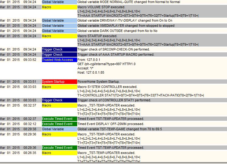

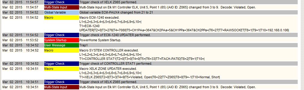

See the two separate log occurrences below:
Note that in this one, I added some user log entries into the offending macro to see what line of the macro failed (the "traps"):
Here are the triggers that could call the macro:

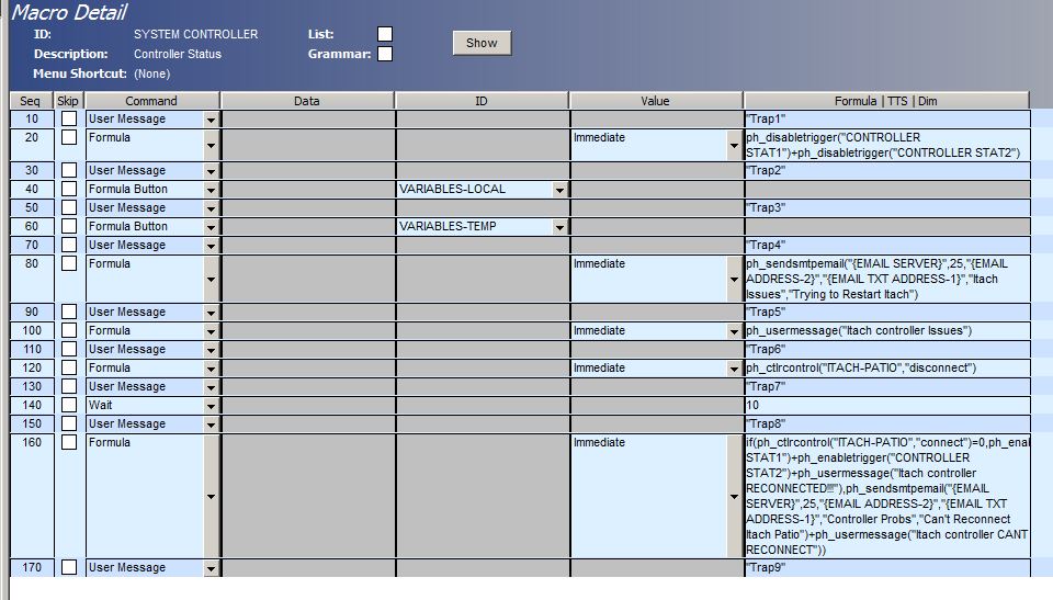

Here is the macro that is called. Note where I added the traps and compare to the last log file:
It appears that the macro stopped executing at line 20. Not sure why. Line 20 disables the triggers so they don't keep continually firing during my attempt at reconnecting the controller.
Ideas? Is there a better way to do this? I need to have my Itach stay connected, or, a reliable way of having it reconnect without PH crashing.

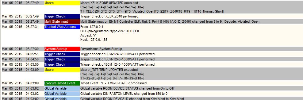

After the PH crash, I restarted PH (without boot). It started normally, except for this:
The log files show me nothing other than the new ECM-1240 trigger I am working on (I am pretty sure this is NOT the cause):

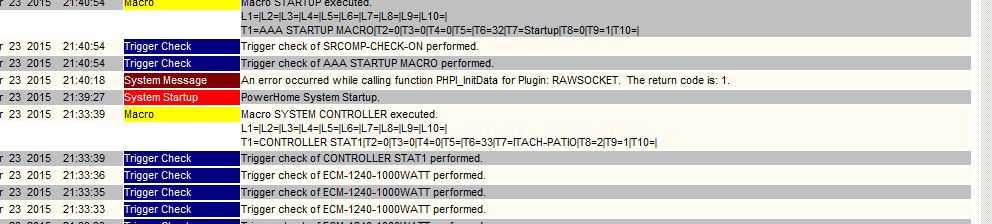

I think I have new/additional information to provide on this subject...where PH just crashes....
By using a trigger that fires a macro (the macro has only one line - it just records the TEMP variables that are past from the trigger... and I have them recorded to the event log) when my iTach WiFi2IR controller DISCONNECTS, I can tell that the PH crash occurs as PH tries to reconnect to the iTach controller. See image below:
The above information is not new. What I believe is new follows:
Note - I have two physical Global Cache brand devices. One is my GC-100 (it has two serial ports that require two instances of the PH_VSP.phvsp plugin to use them). The second device is a WiFi2Ir unit. It is the controller for this WiFi2Ir unit that periodically disconnects (causes the trigger to fire).

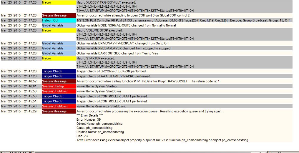

After PH crashes, Windows and my other running programs still appear OK. However, if I restart PH (without doing a windows boot), I find that PH has an error when it tries to load the PH_VSP.phvsp plugins. See the image below:
If I then try to reinit or restart PH again (without the windows boot), I ALWAYS have this plugin loading error during PH startup. The ONLY way to have PH start and load everything with no errors requires a windows boot.
So, it is my thinking that maybe something is happening with the PH_VSP.phvsp either before or after the PH crash... Just another clue....

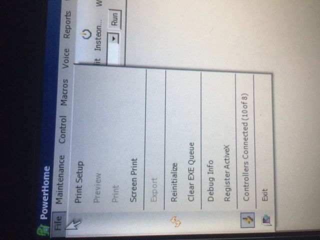

Hmm...Not sure how I could get 10 out 8 controllers connected....
Running 2.15d...I see this fairly regularly after a day or two without a reboot.
Edited by smarty - November 25 2015 at 13:15
Posted: November 29 2015 at 14:31 | IP Logged
Steve,
Interesting...I havent seen this yet. Do you regularly
disconnect/connect individual controllers? If so, what
method do you typically use?
Ive added this to the bug list but let me know on the
above as it will help in tracking it down.
