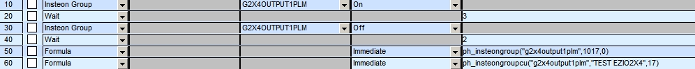

The following Macro controls button 3 of the KPL in your case. Seq 10/30 is the simplest way to turn ON/OFF the KPL button. Seq 50/60 turns on KPL button 3 using lower level primitives
Seq 10 turns KPL button 3 ON using the Insteon Group macro command
Seq 30 turns KPL button 3 OFF using the Insteon Group macro command
Seq 50 starts the process of turning KPL button 3 ON using ph_insteongroup - 17 is ON command
Seq 60 completes the process of turning KPL button 3 ON using ph_insteongroupcu - “TEST EZIO2X4” would be replaced with the ID of your KPL
To turn KPL button 3 off repeat sequence 50/60 replacing the 17 (ON) with 19 (OFF)
Macro Turning ON and OFF Button
