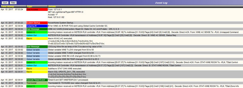

Posted: April 15 2017 at 08:05 | IP Logged Quote GadgetGuy
I have been successfully running the Global Cache WF2IR unit now for several weeks except for 2 occasions when PH crashed and stopped working.
I originally experienced this issue while working with IR Emitters on the WF2IR, every time I unplugged an emitter, but once everything was operating there have only been these two lockup failures.
Here is my Event Log after restarting PH hours after it failed...
The Lockup occurred when the IR Command was sent at 2:30:04 in the morning.
Dave - If I can do anything to capture helpful information to assist you in debugging, please advise.
