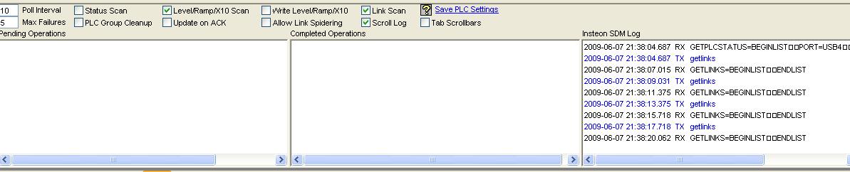

The key option "Enable Pending" which must be checked for Powerhome to write link records is not in your screen capture. If you are changing Level/Ramp/X10 information the Write Level/Ramp/X10 option must also be checked.
Posted: June 07 2009 at 22:26 | IP Logged
Try clicking the Refresh button. Did any of the Pending or Completed activity speak to creating links? If you have not moved the controller to a house outlet not attenuated by a surge suppressor, the link create activity could have failed and the Switchlinc device could be red shaded again.
Reinit is needed when you change the Controller settings under Setup. Also if you add a new device Type. Probably others that do not come to mind. Generally day to day things do not require a reinit. When you have done everything right but cannot understand why you are not seeing the expected results, try reinit. My philosophy. Creating links do not require a reinit to see the results.

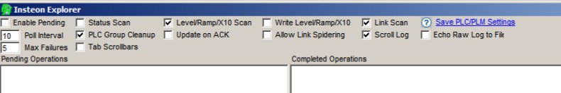

Where the heck is the "enable pending" check box?

EDIT: the Enable Pending option is in the upper left corner of the Insteon Explorer screen.

My screen shot shows that the enable pending option isn't there. Am i missing something?

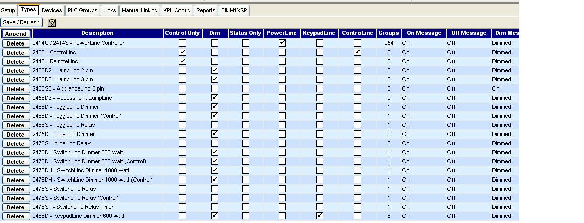

Under the "types" column should they all be checked off under the "control only"

This is the screen capture of my Insteon Explorer on 2.1b. What release of PH are you running?

Only devices which are Control Only should be checked as Control Only. Powerhome is pretty good at noting those so unless you are adding a device Type to Powerhome that does not have a predefined Type, you do not want to change the Control Only column.

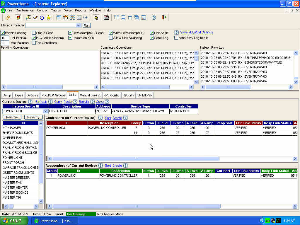

Ok, let's go just a little deeper with my own understanding of this...let's look at the following screen shot as an example:
Based on this, the following questions arise:
1) Once you have all the check boxes at the top the way you have them, is there a way to save a "default" for Insteon Explorer so you don't have to re-check them every time?
2) I read something somewhere in the forums that says to check "Enable Pending", but I haven't been able to find it again, and wondered why we do this?
3) I don't like to have "Status Scan" checked because frankly it's annoying while I'm trying to configure these links. Is that ok?
4) Since it's working the way I want it to, I figure it must be, but wanted to ask if everything else is setup ok...?
5) Down to the actual links now. For the selected "FOYER LIGHT", I have it in two Insteon Groups - one that is just a test group (group 7), and one that is part of the "ALL LIGHT" (Panic Button) group 111, each set to a different ramp rate. For controllers, is this the correct approach to managing a single device in multiple groups, or "scenes"...?
6) There would never need to be another "PLC RESPONDER", right? There could be other responders, but not another PLC responder...?
7) You can set "BUTTON ID" on the PLC...why?
8) You can set "Desired Level" and "Ramp Rate" on the PLC....why?
Ok, that's a good fistful of questions....I'm really just trying to understand this problem space thoroughly.

Sorry - one more - In a device where there is conceivably no ramp rate (in this case a SwitchLinc Relay) one still has Ramp Rates, Desired Levels, etc. available in the Insteon Explorer Links....are these just ignored?

I give you my thoughts for what their worth. (1) You can save them easily by checking the same boxes under setup-controllers-Settings and they should also save by just clicking Save. (2) Checking Enable Pending while building links and whenever a change is made it goes directly to the queue. (3) I also am annoyed with Status Scan but I do turn it on while I’m building links. (4) Looks good but Lee might tweak it. (5-8) I’ll defer to Lee on the technicalities. (9) To answer the update. If it does not apply then it is ignored. It is difficult to define every conceivable device precisely. Lee is trying get the community water supply on but he’ll beam-up eventually.
