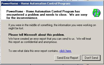

New Powerhome user. I've been looking for something to provide a little intelligence for our mostly Insteon setup here. I've had some trouble with random crashes, and with Powerhome doing the "PowerBuilder Accessibility Error" upon start. Using a dedicated XP Pro SP3 with Powerhome 2.1b and a 2412S PLM, and UltraVNC for remote access. There are a few legacy X10 devices in our setup (none configured in PH) and maybe two dozen Insteon, all factory reset and then reconfigured through PH.
The UltraVNC thing appears to be a real problem, most of the PH crashing stopped if I would restart PH and then immediately disconnect. Not really ideal. However, this morning it was all frozen up, so I connected, and saw
"Microsoft Visual C++ Runtime Library
Runtime error!
Program: C:\Program Files\powerhome\pwrhome.exe
R6025
- pure virtual function call"
Any ideas what might have caused this?

Have you tried uninstalling and reinstall of PH? I wonder if UltraVNC is stepping on some of the PH code. If you disconnect before the optional 2 reply messages and it appears to keep running you might try running without the messages, Setup – Preferences. Also if you get a message that gives an option to e-mail the results do it and Dave will respond in due time.

I can try reinstalling it, but this is essentially a fresh install. UltraVNC is installed during the automated OS install, so it was there first... I used to run PH on a laptop with a USB serial adapter, for the Insteon Explorer functionality, and that had constant problems, which I thought were all due to the USB serial adapter. It got much better once reinstalled on a PC with a real serial port, but would still crash frequently. I wiped out the PH database and started over. It might have gotten better. I factory reset all the Insteon devices and configured them all exclusively from within PH/IE. It definitely was better than when I started. So then I loaded up a dedicated box. It's about the same.
It was up for several days when I didn't do anything to the box (i.e. no VNC). This morning, I attached to find out why it crashed (see above). Restarted. An hour or two later, not having disconnected VNC, it's dead again.
It's so frustrating to have something as intriguing as PH and not be able to rely on it.
