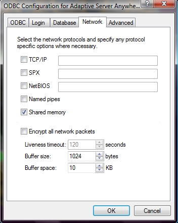

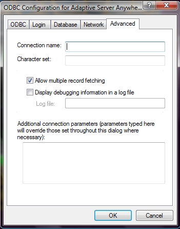

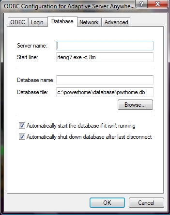

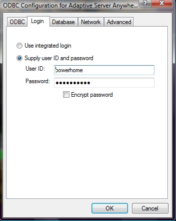

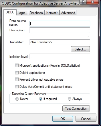

Here's what the other screens look like.

The only thing left I can think of is reinstall it using defaults and move the ini and db over to the new directory and change the path for db. Run as admin and uac off. See if that changes the equation.

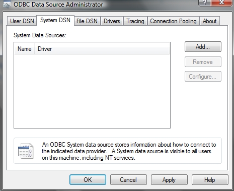

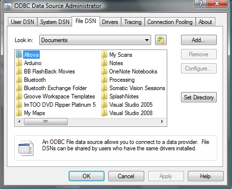

Thanks for help. I took some screenshots of my ODBC System DSN and File DSN. Didn't see anything for powerhome.
Looking fwd: to getting at it. Thanks.

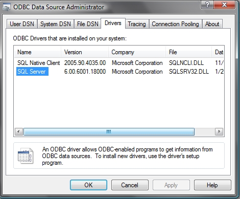

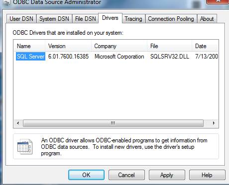

This is what mine shows maybe it will lead you to something…

I have the SQLServer Driver installed too.
