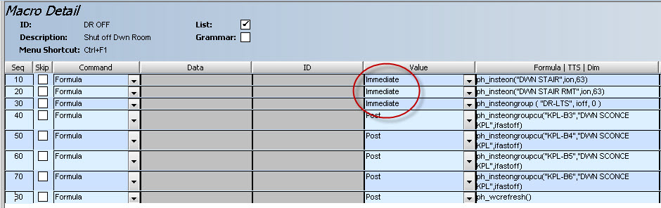

What I suspect is happening is background Insteon processing bogging things down. The way PH works is that all actions go into the execution queue. Its a first in, first out type of thing. When you trigger the Insteon Off command, the Insteon controller (PH control module) will receive this command and fire a trigger check (this does not go through the execution queue and triggers are fired as they occur). If a matching trigger is found and the Boolean field is true, then the "Action" of the trigger is added to the end of the execution queue (in this case, your DR OFF macro). If other items are ahead of it in the queue, then your macro may be waiting for awhile before it even runs. Once the DR OFF macro gets its turn in the queue, then the first 3 immediate commands will be executed right away...pending any the completion of any background Insteon processing. The Insteon controller (PH module) has several queues of its own. One of them is the direct command queue (what these commands would hit)...it has top prority. The second one is the group cleanup command queue...not group cleanups that you specifically issue (those are treated as direct commands) but group cleanups initiated via the built in PH processing as the result of sending a group command (which is also a direct command). Last is the background Insteon process queue. What could be happening to also slow down your processing is that if you've got background comms happening quite often and you've got alot of database scanning not using extended commands (8 Insteon reads per record) and perhaps not the greatest communications, then any direct commands will wait for the current background operation to complete. If you've got "Enable Pending" checked, then the background queue will always have something in it (unless all your devices have failed comms). An item from this queue will be processed once every poll interval. If this operation happens to be a link scan, that is 8 individual Insteon read operations. If the comms are a little iffy, you'll also have up to 3 retries per read. This could take several seconds before a background operation is completed. If a direct command is placed in the queue while one of these background operations are mid process, then the direct command will wait until the current background operation completes. After the background op completes, the direct queue will be checked and ALL pending direct commands will be executed. After the direct queue is empty, the group cleanup queue will then be processed. If a direct command arrives before the cleanup queue is empty, it will be processed as soon as the "current" cleanup command completes. Only after the direct and cleanup queues are empty will PH go back to processing the background queue. But the key here is that the direct (or cleanup) queue is only checked "after" the current operation is complete.
The rest of your lines in the DR OFF macro are "Post" commands. What this does is add the formulas to the end of the execution queue. So they wont run until the current macro is completed. If the DR OFF macro was the only thing running, then they will execute in order just as if they were immediate in the DR OFF macro.
So to sum up, the immediate commands will be executed immediately, they don't go to the execution queue but they don't even get a chance to run until the DR OFF macro is actually executed on its turn in the execution queue (other macros/formulas may be ahead of it). Posted commands go to the end of the execution queue. When the immediate commands are executed, they will wait in the Insteon direct command queue until the current Insteon operation being performed is completed. If a currently running background operation is taking a long time or there are other Insteon direct commands already in the direct command queue, the new commands must wait their turn.

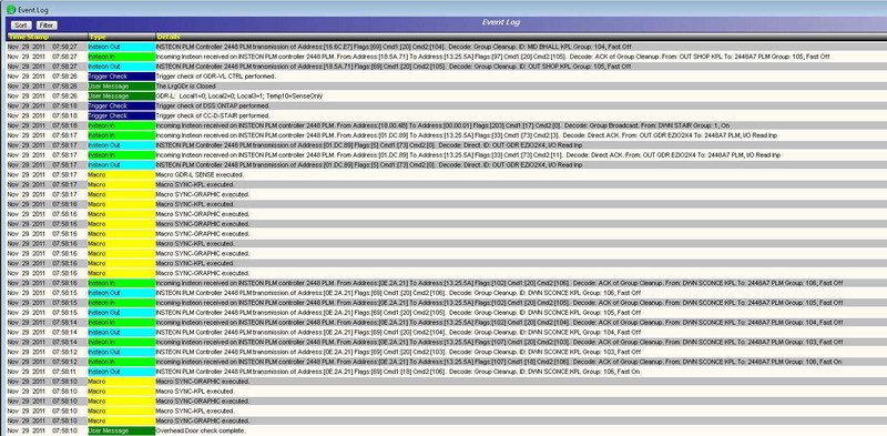

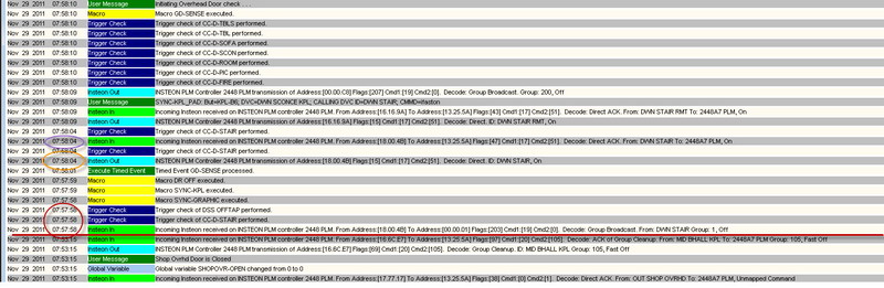

Here is a screen capture of an attempt to turn off the room lights this morning. I lucked out and tapped the controlling switch just before a Timed Event occured . . .
It took a lot of image size reduction and compression to meet the 150K upload requirement, so these are a bit hard to read. [Sorry about that.]
Note that the light switch off tap was seen at 07:57:58 (red circle) and 6 seconds later (07:58:040 (orange circle)there was a Insteon Out commmand that turned on (actually dimmed back from off to a 20% on level)the light attached to the switch.
That command was fired from my macro but there was also a Group Off command issued by the macros that didn't happen. So I tapped the On (top) of the paddle switch at also the same 6 second point (purple circle), not realizing that some response to my initial tap was happening.
The Group Off command apparently was never seen by the room lights as nothing seemed to happen in that respect, although the KPL sync macro seemed to be turning the KPL buttons off.
What I captured is almost a best case scenario!
Usually I have to wait up to a minute before I get a response to my switch tap!

Appreciate the screenshot but its too difficult for me to make out with any certainty. Feel free to email it to me and I'll be able to make a better determination.
The one thing that I can see and you mentioned in your message is that you're basically firing two triggers off of the one Insteon in message and what looks like DSS-OFFTAP (the second trigger) is what I believe is calling your DR OFF macro. When you have the case where multiple triggers can fire off a single condition, you can control the order of which fires first by the ID of the trigger. Triggers are fired alphabetically by ID when multiple triggers are fired. Since the second trigger is just a cleanup of keypad buttons, I would prefix the ID with a Z to make sure it always fires last since its just cleanup routines. This may help make the response time a little quicker for other things like your DR OFF macro.

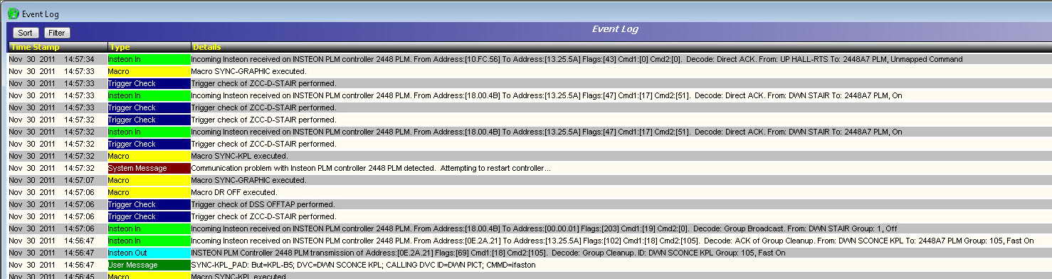

Sent you requested screen caps by email. For the bebefit of the forum I post here what happened with the "dangerous" ExecQueue trick.

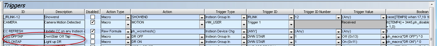

I created a Boolean formula like this (switch on/off taps circled in red) See Boolean formulas in right field. . . .
It didn't seem to fire quickly after I tapped the switch at 14:57:06. After about 5-6 seconds the DR Off macro seemed to execute. But when I looked at the Event Log I discovered that there seemed to be a Comm Problem with the PLM (See System Message). . .
This is repeatable. I tried several times and always get the same Comm Error. Perhaps when the Queue is bypassed, some needed .dll is skipped over?
Also I note that although I renamed the Triggers so that the low priority actions started with a "Z" that the ZCC-D-STAIR seems to have fired first in the Event Log!?

My macro to turn the Down Room lights off consisted of Insteon commands to turn the light switch I just tapped off, back on to a dim level for night lighting, and a Group command to turn the lights off . . .
    ph_insteongroup ( "DR-LTS", ioff, 0 )
where the "DR-LTS" have been defined in the PH PLC/PLM Groups tab of IE as the room lights.
Even with the "dangerous" Boolean formula trick it was still taking 20 seconds to turn the (group) room lights off, although the light just tapped off does come back on almost instantly.
So. My curiosity aroused, I started debugging.
I found that if I make a single line macro with "ph_insteongroup ( "DR-LTS", ioff, 0 )" as the entry, and then "Play" it. It takes about 20 seconds before the lights go out.
I thought a Group command was supposed to be quick, but clearly it is NOT.

Concerning the ZCC-D-STAIR trigger firing first...is it an Insteon Group In trigger like DSS OFFTAP or is it a different type of trigger? I checked the source and an Insteon Device Change trigger will fire before an Insteon Group In trigger does. I should have clarified that triggers of the same type will fire in the alphabetical order of their ID but different type triggers fire in a particular order. In this case, you could create a virtual Insteon device as a responder of the controller that you're firing for Insteon group in and then create an Insteon Device Change trigger for the virtual device with a lower ID.
Performing an action in the boolean field does have its risks. I wasnt sure if the recent changes I had made to the Insteon controller would resolve the issue but it looks like it hasnt. Performing an Insteon send while an Insteon receive trigger is firing is still apparently a no no. You should be safe performing an innocuous formula such as updating a variable or similar but nothing that would result in an Insteon send being performed while in the midst of an Insteon receive. My bad .
The Insteon group command should be quick. It doesnt require an ack and all devices that respond to the group should do so very quickly. We would need to see the event log to see how long between launching the macro and sending the group command. If the time is negligible but the devices didnt respond for some time, then it may be a communication issue and its possible that the light didnt respond until the group cleanup was sent (which could take a little time). Would need to see the eventlog to be sure.
