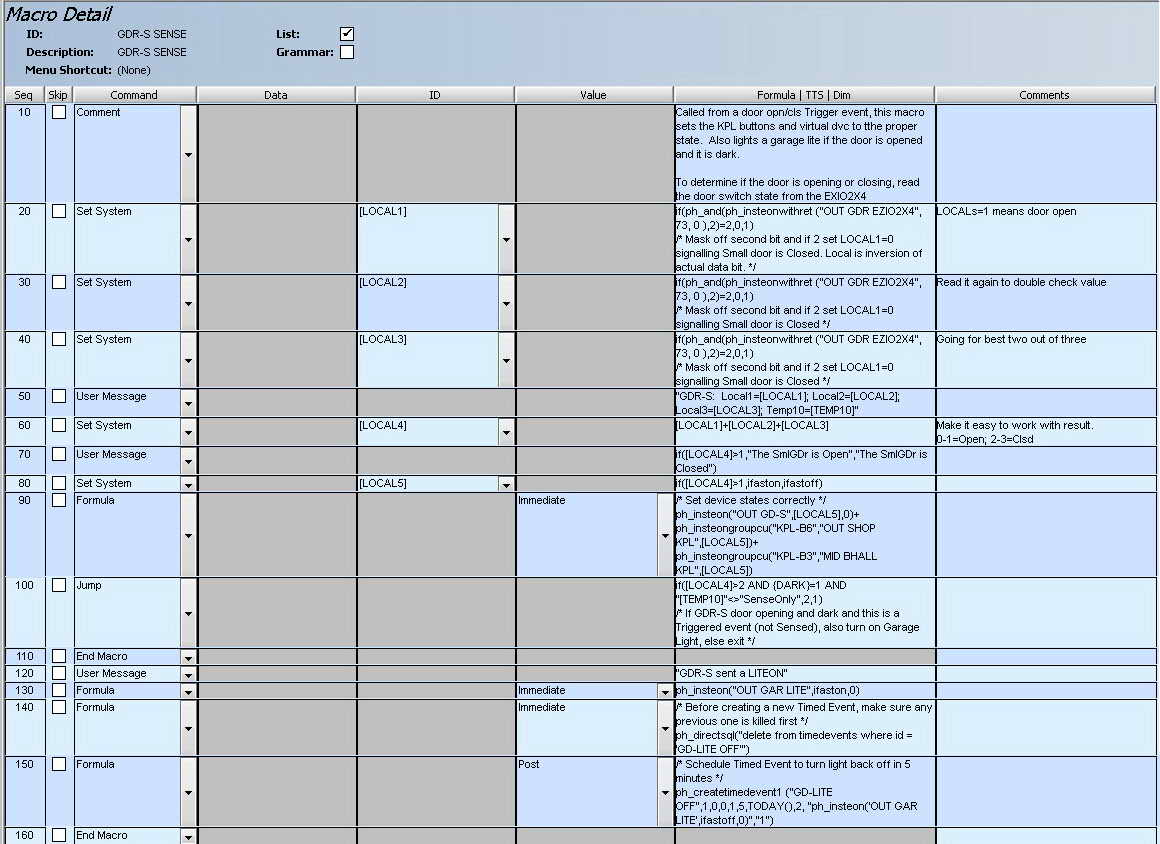

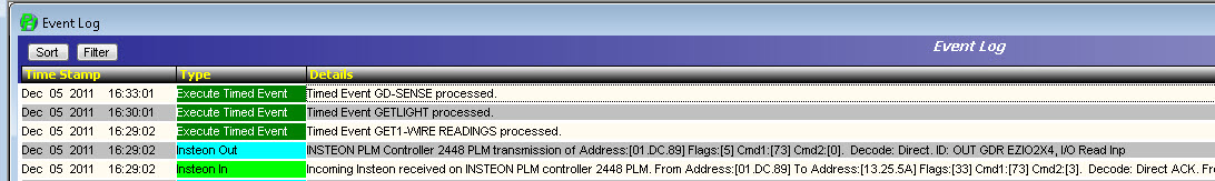

In testing further on this "slowness" issue, I just captured the following scenario that demonstrates what I have been experiencing.
At 16:32:45 I selected "PLAY" for the "DR OFF" macro, but it never fired. Even after 5 minutes of waiting it never kicked off.
Looking at the Event Log (snapshot taken at ~16:34.10), my Play "DR Off" never even showed up. A log refresh several minutes later still showed no DR OFF execution.
The Execution Que kind of tells the story. It appears that my Garage Door state sensing macro was running, and running, and running. In fact after 5 minutes, it still was stuck in the queue until I executed a Clear Exec Que command.
Here is a listing of the Garage Door Sense macro . . .
Does this reveal anything to you?

You could be hung waiting for insteonwithret if it is encountering errors. But it should eventually clear. For those type of back to back commands I stick a short a wait in case someone wants to jump to the front.
Posted: December 05 2011 at 22:58 | IP Logged
Pete's most likely right. I would think the ph_insteonwithret functions as the most likely suspect.
I'll trace the oode tomorrow to determine what happens if there are COMM problems while calling this function.
I think y'all have hit the nail on the head. Thinking back on my experiences, it seems like I have always noted that when PH performance seems very slow, I have seen that the Overhead door check macro was in the execution queue. Since it checks three doors every time it runs, there is a lot of potential for delays if the ph_insteonwithret function encounters issues.

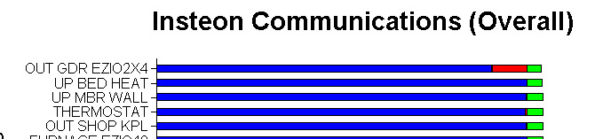

I have noticed over the years that the EZIOxxx modules do not seem to have as good Insteon comm reliability as SmartHome units. Virtually all of my 70+ SmartHome Insteon devices have a COMM reliabily of 98-99% but my EZIO units seem to typically be in the 89% range (despite the fact that I have 2443 Access Point boosters within 10 feet of all my EZIO devices, otherwise there were almost unusable!) . . .
Per Pete's suggestion I put in 0.5 second Waits between the EZIO Read attempts, while that will help open the queue up to others during my back to back read attempts, I'm assuming that it won't really help if a particular read attempts gets hung up. The Wait doesn't get executed until after the ph_insteonwithret excution goes to completion, does it?
Dave does it make any sense to add a "timeout" parameter to the ph_insteonwithret function, so the read attempt aborts if unsuccessful for too long?

Just wanted to post that I have been able to make a
SIGNIFICANT improvement in my overall performance this
morning.
I inserted 0.1 second Waits in every macro that polled
multiple devices or used a ph_insteonwithret function. I
had several macros that were quite long and ran often
(every ten minutes, for example) to poll device status,
or to update KPL button light states.
All of these now have WAITs interspersed.
I also enhanced (per BeachBums normal approach) my light
off macros (from a single switch tap) so that they do,
then test the results, and do again if needed. Using
judicious WAITs and limiting the tests to a max of 10.
