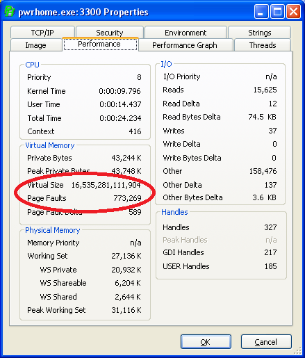

First, I'd like to thank Pete (BeachBum) for all his time and help today. He really went above and beyond. Even though we didn't identify the problem, we went well beyond my level of PC expertise and I learned a great deal.
So Pete and I spent some time looking at this and we're both still scratching our heads. The one odd thing that we came across was the virtual memory as reported by Process Explorer. It's totally out of whack and we don't know why.
We looked at some other running programs and saw similar numbers for virtual size. We even tried turning off the page file and still got this. This would appear to be a problem with my Windows XP installation and PH 2.1.4 obviously does not like it. I guess the next step at this point is for me to reinstall Windows XP. Not sure when I will get to this, but I will report back when I do.
Mike..
