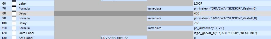

Hi Dave - Hope all is well.   As you know, I completed the update
last week. Everything appears to work perfectly with one
exception. I have a piezo-electric buzzer in the middle of my
house, controlled by an on/off module. I use Powerhome to send
on/off commands separated by hundreds of milliseconds to send
different patterns (one long beep, 2 short beeps, etc). When I try to
send 2 short beeps, PH consistently gives me the "Communication
problem (No Response) with Insteon controller PLMMODEM
detected. Attempting to restart controller (1 of 5)" message. I get
this message 100% of the time running this particular macro. I get
it only once, and I do not get it any other time or place. The
problem is that i get it between the 2 beeps and so instead of 2
short beeps I get one long one :-(.    This started with the update
(never saw it before). If you have any suggestions on how to fix or
work around that would be awesome. Thanks!   I'm trying to
upload a screenshot of the macro (29KB jpg file) but not sure I'm
succeeding.

Jeff,
You successfully uploaded the screenshot but the forum will often muck up the code. I went in and edited your post to fix it.
I'll do some testing with your code and see what I can come up with. If I understand the code correctly, you send a fast on, delay 400 milliseconds, send a
fast off, delay 750 ms and then repeat. How many times do you loop? I see LOCAL7 is your counter but not sure what value it starts at.

Posted: July 11 2022 at 15:52 | IP Logged Quote jeffw_00
Hi Dave - thanks for the quick reply. You read it correctly, I loop twice.
Note that the times used to be 750/750 but I shortened the first one as
a partial (and not very good) workaround to compensate for the pause
PH adds to do the restart before it turns the beep off.   Thanks in
advance for anything you can do.

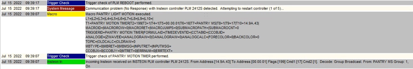

Like Jeff, I am also receiving numerous System Errors from the comm issue with the PLM. Mine appear to be generated after 10 seconds without a comm response. I have several macros like these, but I am pretty sure that the PLM is on a different phase and subpanel than the devices with the two offending macros. Of course the phases are bridged wirelessly and with numerous wireless (dual band) devices, but it might explain why the comm is not perfect.
In case it aids in the troubleshooting process, I am posting screenshots of the logs and macros.

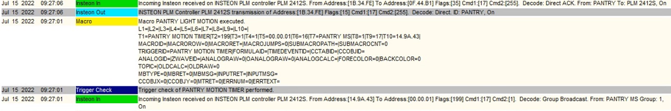

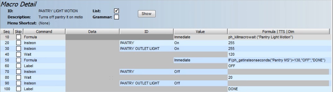

Here is the Macro of PANTRY LIGHT MOTION:   Basically it restarts waiting macros, then sends ON commands to two Insteon devices, starts a two minute timer, sends an OFF command to one Insteon light, waits 20 seconds, then sends the OFF command to the second Insteon light.
The communication problem seems to be logged 10 seconds after the macro is executed and no Insteon ON commands are logged from the PLM to the two lights.
NB. When the macro does NOT generate a System Message (comm error), the log records an Insteon OUT command within 5 seconds (and direct ack from the Insteon devices in the same second).
In both cases the actual pantry light DID turn on but probably because the lights are linked directly to the motion sensor (and the macro is a backup and turns the lights off after 2 mins).

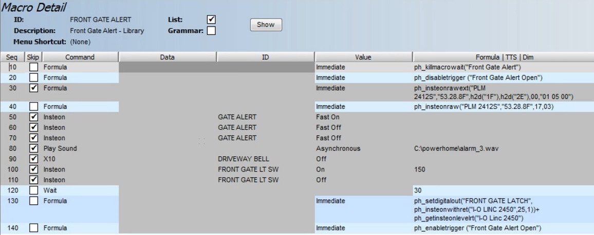

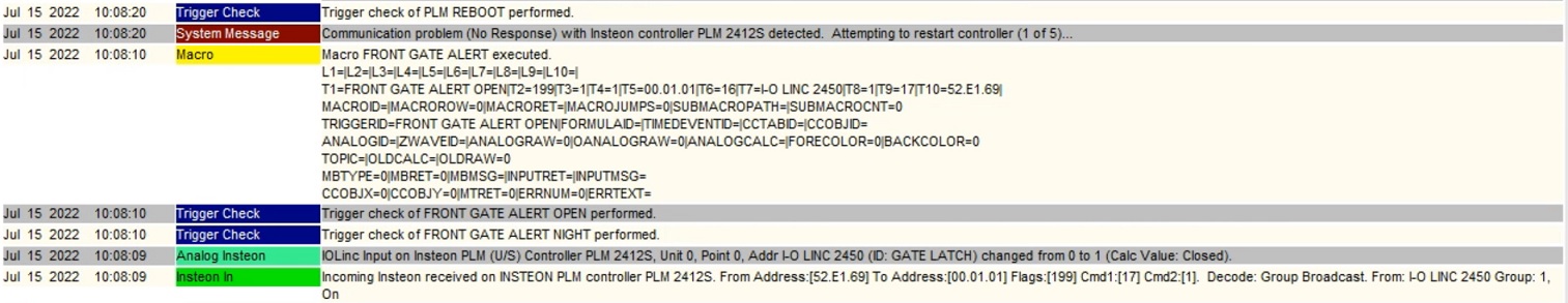

The second "offending" macro is similar to Jeffw_00's. If a front gate is opened, it triggers an Insteon chime. This is generating the same System Error.
This macro of FRONT GATE ALERT kills any other waiting macros and disables the trigger, then sends a raw Insteon command to the Insteon chime to activate (On) for 3 seconds. The macro then waits for 30 seconds and queries the I-O Linc device for its sensor status (i.e., open or closed) then re-enables the trigger (the skipped commands are from the original macro which I left in for potential future uses).
The log of the comm error shows the error logged ten seconds after the macro is executed.
The only command in the macro from the PLM is the raw Insteon command: ph_insteonraw(“PLM 2412S”, 53.28.8F,17,03). FWIW, the chime is responding, usually within 1-2 seconds of the sensor opening, but sometimes (esp. at night) not for as much as 10 seconds. Also, it does activate for 3 seconds, which I’ve found plays the chime twice. Sometimes the chime activates for longer such that it plays three to six times! I don’t know why. I’ve chalked it up to the usual Insteon gremlins (which is why I've upgraded to 2.2 to begin experiments with MQTT, ZWave, Zigbee and Tasmota).
I never received these errors in 2.15e, but get it constantly in 2.2. Some solutions would be to reduce the sensitivity of the System Error from the comm error or maybe to be able to trigger the PLM to reset after more than the first of five attempts. Right now the trigger is ANY System Error and not the specific System Error – can this be done if the comm error sensitivity can't be altered? In the meantime I've turned off the PLM reset trigger.

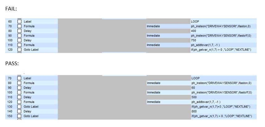

Hi Dave - I'm wondering if you've had any luck with this (sorry, I'm
reminded daily since it is in a macro that triggers a couple of times a
day).   But here's something weird, I realized I have two different
macros with very smiliar code. One gets the comm error 100% of the
time, the other gets the comm error 0% of the time - See the
attachment. I can't guess as to what's different... Thanks in advance
for anything you can do... (The module DRIVEWAY_SENSOR
actually is an appliance module that has a relay plugged into it, the
relay supplies power to a piezoelectric buzzer).
