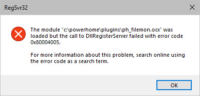

But a re-registration effort then resulted in...
I then reloaded the file monitor unZipped files into the plugins folder but get the same error as above.

The first error message looks like you may not have executed the regsvr32 command from a command prompt run with Administrator
privileges.

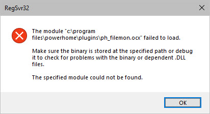

The second error message has an improper path of "c:\program files\powerhome\plugins\ph_filemon.ocx".

The 2nd err msg does show an incorrect location of the
files. I had caught and corrected that but grabbed the
wrong screen cap to post here.
Everything IS in "C:\powerhome\plugins\" with the correct
filenames.

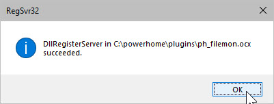

Posted: November 27 2022 at 18:10 | IP Logged
Nope. Redid everything and still no success.
I think I have everything right.
PS- I did both an INIT and a total restart to see if I could succeed with the last graphic. :-(

Posted: November 27 2022 at 20:49 | IP Logged
Not sure what you did different this time around but your first screen cap shows that the DLLRegisterServer succeeded this time so you should be good
with the FileMonitor being registered now.

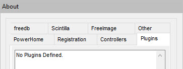

In your "Setup Plugins" screen cap, you need to have a checkmark in the "Active" column in order for the plugin to be activated. Once you do that and
restart PowerHome, you should be up and running.
