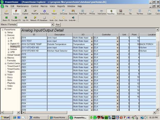

After the PH2 upgrade, The ELK temperature zones come up as
-40 Degrees.
Id Codes 2,1 and 2,2
Temperature probe of 0,10 works fine. Please help

Posted: October 03 2008 at 21:21 | IP Logged Quote smarty
Works ok for me.....
Are you talking about using one of the first 16 zones on the Main Elk board (as I am)? See zone 16.

No Smarty, My Temperature probe works. It's my Aprilaire stats 1 & 2 that are out (Climate control)

Maybe the same bug.... No keypad Temperatures.
From the Elk Help Section:
When defining digital outputs, multi-state inputs, and analog inputs, the controller will be the ID of the Elk controller, the unit will be the board number from 1 to 13 (1 is used for the controls onboard the Elk), and the point will the individual device number on the board from 1 to 16. Temperature inputs will have a unit of 0 for temperature probes, 1 for keypads, and 2 for thermostats. The point value for temperature inputs will be from 1 to 16 corresponding with the available units in each category.
