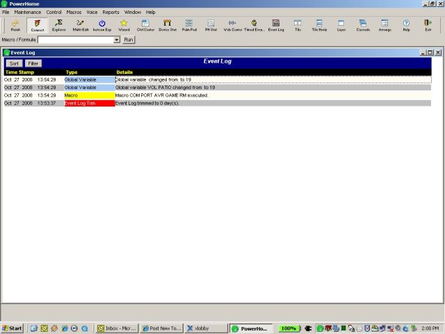

Possible bug or user error:
When I use the "ph_setglobal_s" or "ph_setglobal_a" in a formula line of a PH macro, the global variable that I am trying to set does not get set.
My global variable {pick your name} has already been defined in the GV list. When this line of the macro fires, the event log says something like:

My code looks something like:
ph_setglobal_s("{ELK ARM STATUS}","[TEMP5]")
-The formula verifies to a "1" value (so the formula seems ok).
-{ELK ARM STATUS} has been pre-defined in my GV list.
-My event log is similiar to my earlier post; where the GV name {ELK ARM STATUS} does NOT show up in the event log.
user error???

Try this and see if it works - just a thought:
ph_setglobal_s("ELK ARM STATUS",ph_getvar_s(2,5))

OK, it was a USER ERROR. The {} brackets around the GV where causing the problem.
