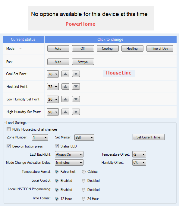

My 2441TH Stat seems to have quit responding, and can't get 'er goin' so tried Factory Reset (didn't work) but in the process thought I would take advantage of the new I2CS support to use software set it back up after the reset, instead of the many and bazar manual operations otherwise required.
BUT to my dismay, there seems to be no Device control Options in the PowerHome Device window.
The Old SmartHome HouseLinc software offers extensive control features, but not PH.

Posted: November 24 2014 at 14:37 | IP Logged
Ken,
The plan is to eventually have support for extended options for all Insteon devices (where specs/protocol have been published). I have the docs for the newer themostat devices but it definitely won't make it into the next release (2.1.5b) due to required database changes which Im trying to avoid in this release so I can get it out ASAP.
Perhaps 2.1.5c.
