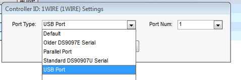

I am suspicious of the fact that the device types in the controller pull-down list do not mention my Maxim USB 1-Wire controller, which is a type DS2490, which is not listed.
I have thus tried the "Default",and "USB Port" options(which yield '-2') errors, and the "DS90907U Serial" which yields a "..error returned while performing setup for 1-wire controller.. Return code:3"

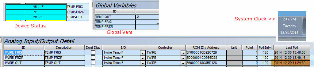

The Device Status frame shows 2 of 3 temperature readings, none of which have changed since they were initially read.
The TEMP-OUT was scanned yesterday at 2:24PM when I first entered it into the Analog I/O Detail Table, and the other two were scanned today at ~1:46PM when I first entered them in the Table, but the TEMP-FRZR temp was apparently not read as it is null.
The one Global Var that holds a value is the TEMP-OUT which occurred at about 2AM this morning, but resulted in a (-2) error.

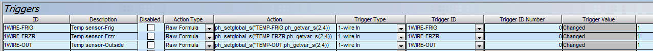

Here is what I am using in my Trigger. Is this the wrong approach?

Changed the Trigger formulas to...
| ie, ph_setglobal_s("TEMP-FRIG",ph_getanalogcalcstat("1WIRE-FRIG" )) |

You've got the triggers setup properly. A trigger ID number of 0 would mean to trigger on any change (that has caused an update in Device Status).
