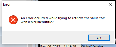

After a major disk crash, I just reinstalled PH, but now when I try to Setup the Web interface I get a missing webserver|menutitle error message which is also a fatal PH error that terminates execution...
Is there any way to fix that without having to reinstall ph22beta3.3?

What do you have showing for this value in PowerHome Explorer under Setup->Web? You may need to manually look at the pwrhome.ini file to see what is
stored under the [webserver] section for menutitle7.
I suspect there is an illegal character or something is not filled out properly. If you cant see anything wrong, post the full menutitle and menuurl
settings that you've got.
