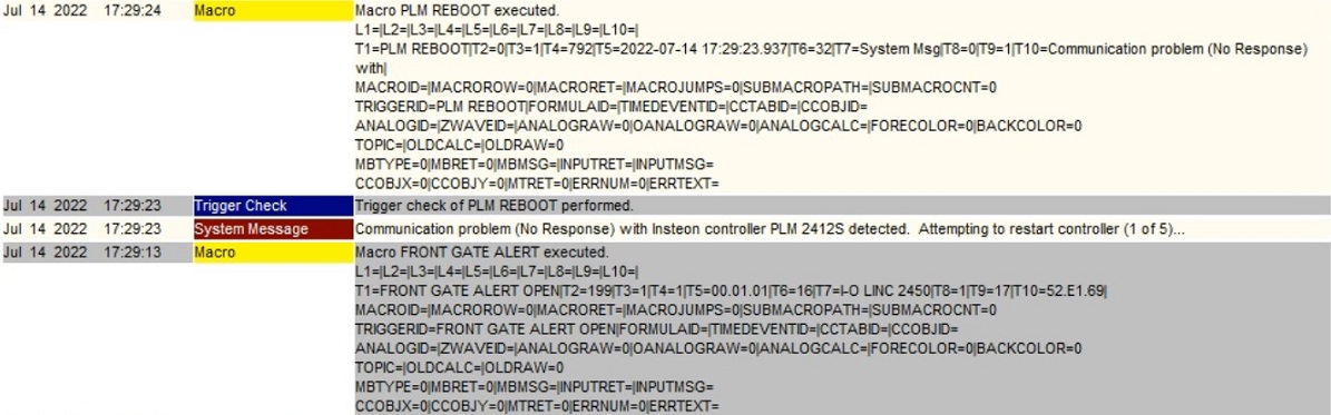

I, too, finally made the switch from 2.15e to 2.2 with this beta 3-5 (latest) patch. I followed Dave's recommended upgrade procedure to a tee and all seems good EXCEPT I am having comm issues with my (old?) PLM. I have a trigger in case of a System Message to cycle the power on the PLM and that usually fixes it. It usually happens once every few weeks. Since upgrading to thus version I am getting on average two every hour. My PLM is a Smarthome 2412S Serial PLM. It says V1.9 on it with a date of manufacture of 2008 (I think I’ve re-capped it once from the originals). I tried changing the powerhome.ini file in the [PLM] section from pre63=1 to pre63=0, but that seemed to make it even worse. So, I am back to the default setting of =1.
Almost all (9 of 10 in my recent sample) of the comm issues (no response) seem to occur 10 seconds after certain macros are executed . . . but not every time the macro are executed. The line which might be causing the comm issues in one macro is: ph_insteonraw("PLM 2412S","53.26.8E",17,03). (this is just a command from the PLM to an insteon chime to play an alert tone. The other macro simply turns on two insteon lights.
Example of comm "no response"
Any idea what could be causing all the comm issues or how to track it down?

I'm having them too (see related thread) and Dave is aware and
working on it.

I'll repost with the macro in the other thread. I read through all the posts on the updated version of PH last week and decided to take the plunge over the weekend. Your last post on the "patch" thread seemed like things were working properly and I missed that you started the new thread.    Interesting that we're both having very similar symptoms with "timed" commands.

Im definitely working on this and will direct my replies and results in the other thread.
