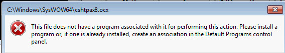

Hmmm...what OS are you running? Its possible that one of the scraper subcomponents also needs registering.
Try running regsvr32 on cshtpax8.ocx. It'll be system32 if you're running a 32 bit OS otherwise it will be syswow64. Make sure you're running the regsvr32 function as an administrator (I like to right click the cmd prompt and select "Run as administrator" and then execute the regsvr32 function from there).
Posted: November 11 2014 at 15:14 | IP Logged
Dave-
I'm running a 64-bit Windows 7 Professional system and attempting to Register cshtpax8.ocx results in the following error message...
Got any more ideas?
Posted: November 11 2014 at 16:36 | IP Logged
It should look like this:
regsvr32 "c:\windows\syswow64\cshtpax8.ocx"
