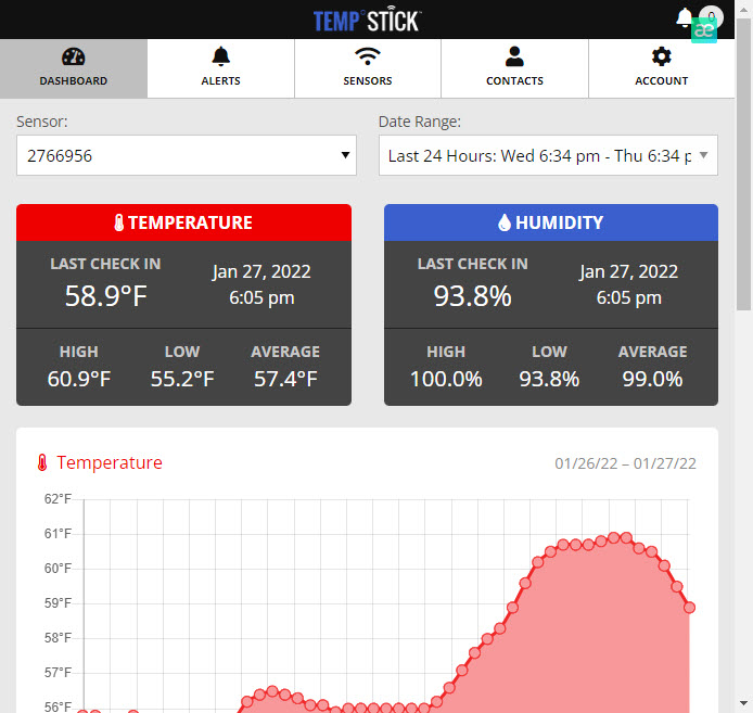

For several years I have been fetching my outside temps from my TempStick (https://tempstick.com/) which produced a (normal) web page with text and html formatting.
But months ago they changed the site from a 50,000 character site to a 400 character site by creating a single Home page comprised of almost nothing but links.
While the link collection produces a viewable web page the ph_geturl1() function sees nothing and I am unable to thus extract any meaningful temp data.
Is there a PH URL function or configuration of one that will process the raw page into the user viewable form see when you access it as a web page which looks like this...
Any ideas of how I can regain this weather page feed?

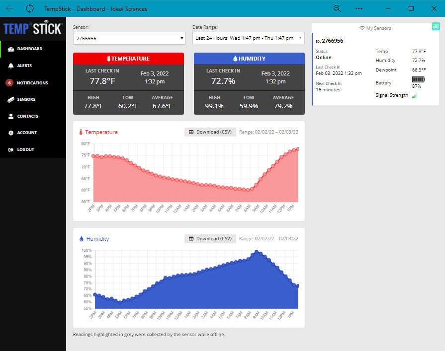

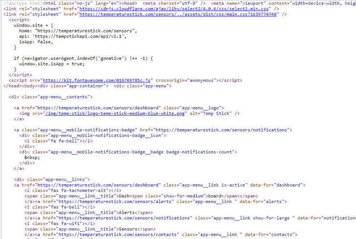

Posted: February 03 2022 at 13:02 | IP Logged Quote GadgetGuy
Thanks Dave -
Please find attached a scrape via URL1 and an image of what appears on my computer screen via MS Edge browser. Note the two captures where taken a few minutes apart so specific variable values may not match.
