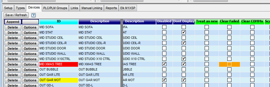

This appears to be a bug in 2.1.5.
I have set the "DIsables" flag on an Insteon Lamp dimmer
I
use for our Xmas trees, as it is not plugged in now.
Yet despite the "ignore" the Comm Err Failed flag still
keeps getting set...
20_185037_commerr.png">
!%$#@@! I don't know why Google Chrome can't post images
to this forum, but IE can. So the next entry is the same
as this one, except posted via IE so the image will
show!!!!
I have set the "DIsabled" flag on an Insteon Lamp dimmer I use for our Xmas trees, as it is not plugged in now.
Yet despite the "ignore" the Comm Err Failed flag still keeps getting set...

Posted: July 20 2014 at 18:57 | IP Logged Quote dhoward
Ken,
Can you check your eventlog for any Insteon transmission to the MID XMAS TREE device? The disabled flag only blocks background operations to a device (PowerHome status scans, link scans, etc). Other commands that the user may initiate will still go through.
Let me know,
Back to Top View dhoward's Profile Search for other posts by dhoward Visit dhoward's Homepage
GadgetGuy
Super User
Super User
Avatar
Joined: June 01 2008
Posts: 942
Posted: July 20 2014 at 19:11 | IP Logged Quote GadgetGuy
Yep Dave, there are many attempts via Timed Events to
manipulate the MID XMAS TREE light levels. They go on all
year. I just figured if the Lamp Module wasn't plugged in
they would be ignored, if the Disabled was checked.
Guess I'll just have to live with it, and remember to clear
the Comm Failed flag next December!   :-)
Thanks for the clairification!!!!
