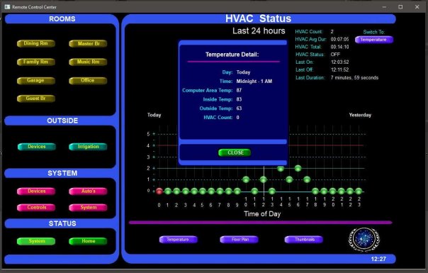

As to popups, the truth is NO, you can't actually do popups, but you CAN fake them really well!
Here's how:
In PH, you can move items in the CC/remote_cc. I use this feature to move the dots on my graphs (as shown above). When my HVAC system comes on/off, I increment a
counter for the hour it happens in, then I move the dot on the page up a few pixels as you can see above. At the end of day, I set the positions back to the base. I
have a macro that gets triggered at midnight, and it does this, and a lot of other "end-of-day" reset type things.
Extending this "move" feature, you can move an image, data, and any object on the CC. So, you can initially put the "popup" way off (x = -1000) to the left side of
the screen (for example), but when you "call it up" you simple move the item into the visible screen ( x = wherever-you-want). The hard part is that you have to move
EVERYTHING in the popup including the background image RELATIVE to the popup coordinates. ("TOP"+x, "LEFT"+x) ( you don't actually HAVE TO move them relatively, but
it's better in case you decide to move the popup later.) I set a global variable for the top/left coordinates of the popup, and move everything relative to those.
So, to move the popup, I only have to change the global top/left globals, and the entire popup and data moves appropriately. Then when you "close" the popup, you
move everything back off the screen (x = -1000). You'll use a lot of macros and variables to achieve this.

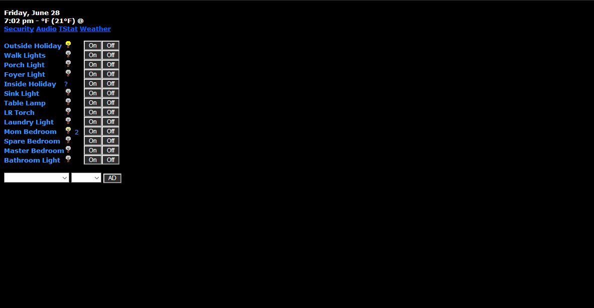

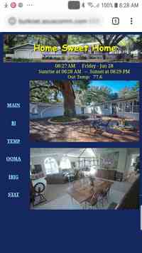

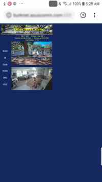

This is an FYI addition to this old thread, but it covers a situation that has bugged me and clearly many others for years. After fighting the fact that my private PH web server displays differently on a PC versus a smart phone, with the phone display only covering about 25% of the screen as I designed my pages with fixed pixel (eg, "320")absolute dimensioning rather than relative (eg, "90%"
Thus, unless I manually zoomed the screen, my PH web pages looked like this...
instead of this desired full screen...
Turns out there is a quick and easy fix provided by modern updates to Browsers that automatically adjust a screen to fit a mobile device.

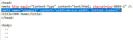

Simply insert this line of HTML Code into your web pages in the HEAD block and before the BODY block.
<meta name="viewport" content="width=device-width, initial-scale=1">
For example...
TonyNo Moderator Group
Joined: December 05 2001 Location: United States
Online Status: Offline Posts: 2889
Posted: June 28 2019 at 19:12 | IP Logged
I found this out a while ago and use...
<meta name="viewport" content="width=device-width, initial-scale=1, minimum-scale=0.5"/>
I deleted minimum-scale and nothing changed. I also tried different values for initial-scale without change. :(
