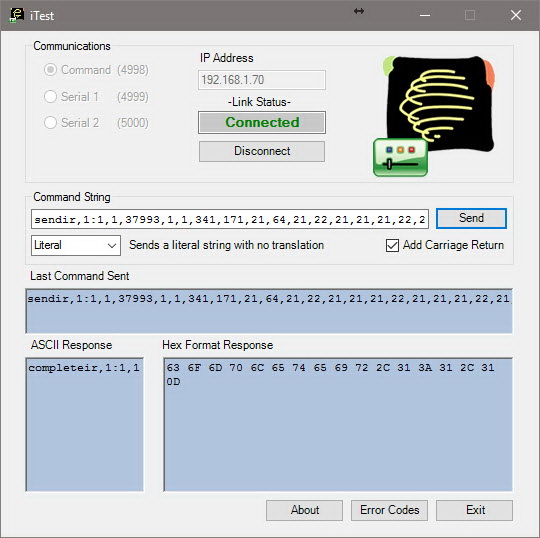

So I started up the Global Cache iTest.exe App and used it to send the identical pronto string I use in PH and NEVER got any duplicate codes transmitted, and thus no problems.
Every CG transmission works and every PH transmission fails (turns the AC on and right back off immediately).

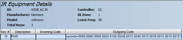

I am using pronto (hex) IR codes for my command definition in the PH Devices>IR>Equipment Details..

I assume this goes in the IR Equipment Details entries, but have been unable to find a syntax form that works there.

This is what the iTest utility sends (this is
everything there are no other parameter windows)..
The full GC Code string I am sendings looks like
this...
sendir,1:1,1,37993,1,1,341,171,21,64,21,22,21,21,21,22
,21,21,21,22,21,21,21,65,21,21,21,65,21,64,21,22,21,21
,21,65,21,64,21,22,21,64,21,22,21,21,21,22,21,21,21,22
,21,21,21,65,21,21,21,65,21,64,21,65,21,64,21,65,21,64
,21,22,21,1599,341,86,21,3700

The GC code string I am using in the PH IR Equipment Details Remote Key definition for my PWR TOGGLE is the same with the addition of "<repeat>3<zone>1" appended to the end. I originally used "<repeat>1" to keep commands from being duplicated, but was then having commands missed totally, so changed the repeat back to 3.
Now that seems to be working OK, since I switched to GC vs pronto format in the Key Code definition. (The repeat=3 seemed to be duplicating commands when used with the pronto code format]
What is strange is that the GC iTest utility seems to always work fine with no missed or repeated commands. I'm puzzled what might be different when PH supposedly sends the same thing and it doesn't work reliably.
