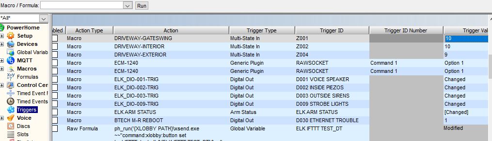

 See the "DRIVEWAY-XXX" top three triggers.  Note that I am attempting to initiate a trigger event when they change to a specific value (a 9 or a 10), not just a "Changed".

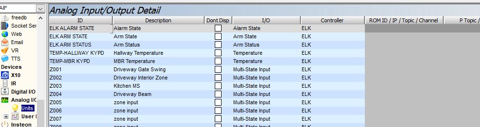

 See the corresponding Elk Analogue Multi-State Input zones that I have set up here:

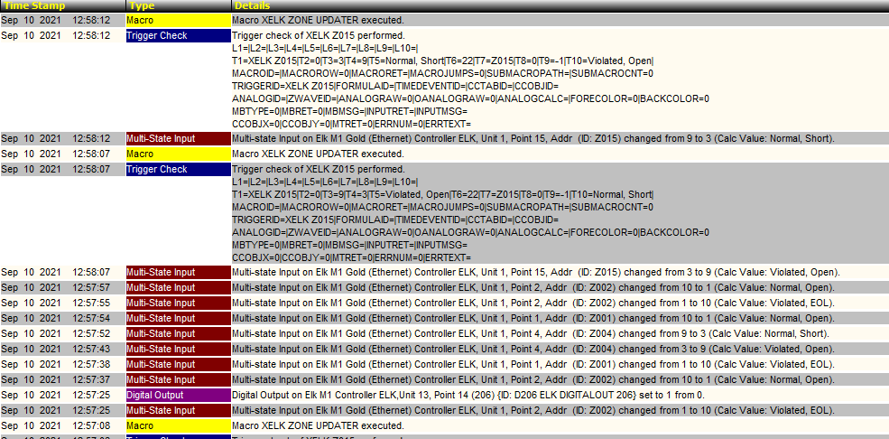

 Now, see the log file where the above Multi-State Input zones 1,2 and 4 should have caused the triggers above to fire (zone values changing from 1-10/10-1 or 3-9/9-3 .  Specifically at time 12:57:25 through 12:57:57.
 My other elk zone triggers fire, but they are based upon a "Trigger Value" of "Changed" rather than a specific unit value.  Is this a possible bug or I missed some changes between version 2.15e VS 2.2 beta3-3 for the elk?  FYI...The above triggers and zones DID work in version 2.1.5e.

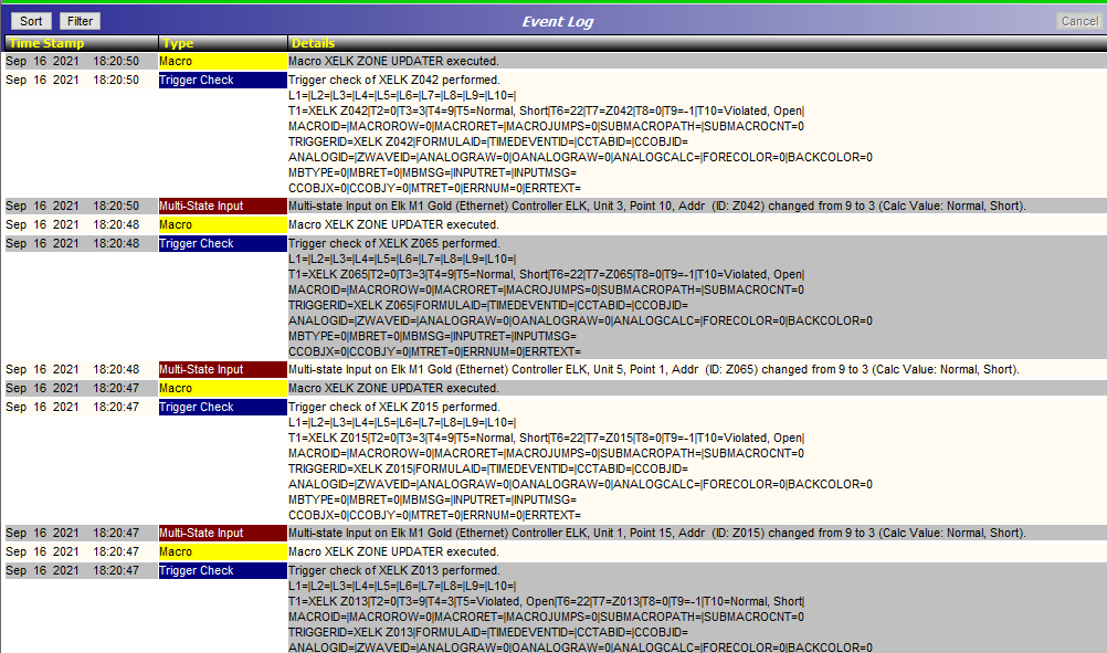

     Yes, it appears that the triggers do indeed fire when checking for a "Change" value; when boolean formula value is met (ph_getvar_n(2,3) = 9 ...in one case, and
 ph_getvar_n(2,3) = 10 in the other).  See below:
