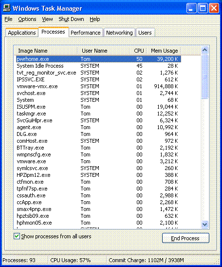

PH 1.03.4.11 SDM308 XP SP2...
 I haven't been able to pin it down yet, but I had two crashes yesterday when using an X10 remote to control some insteon devices.
 The first time PH crashed completely with no opportunity to save debug data.
 The second time PH took one of my CPU cores to 100%.  Since I had another CPU core, I was able to go into Task Manager and kill the process and restart.
 If I'm able to do anymore isolation, I'll let you know.

The problems continue.  They appear to be related to X10 signals coming in.

Tom,
 Try the new PowerBuilder runtimes (link posted in the 1.03.4.11 thread) and let me know if it helps or not.

           | Posted: July 11 2007 at 06:44 | IP Logged
 So far so good!  Obviously, I'll keep an eye on it.
