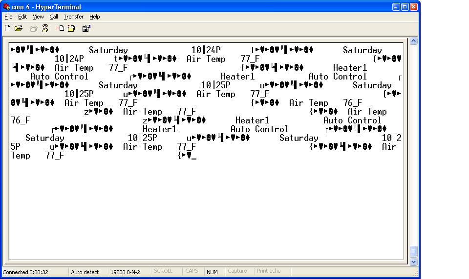

I have my AQ-CO-SERIAL now and have been able to control my pool equip. using the command format TonyNo outlined above.
However, getting data from the Goldline controller is proving much more difficult.
Tony's example macro never stops executing because there is never a "-3".
Looking at the data in HyperTerm there is just a continuous stream.
Here's an example:
Suggestions welcomed.

jbbtex
Joined: February 15 2007
Posts: 181
Posted: May 31 2009 at 14:39 | IP Logged Quote jbbtex
This gets the pool temp.
10 Set System [TEMP1] ""
20 Label Next
30 Set System [LOCAL1] ph_comrecvstring( 1, 1 )
40 Jump if( "[LOCAL1]" = "H", 3, 1)
50 Set System [TEMP1] "[TEMP1]" + "[LOCAL1]"
60 Goto Label "Next"
70 Set Global POOL TEMP ph_regexdifF("pool temp", "_F", "[TEMP1]", 1, 0)
Brady
