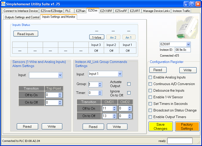

I have an EZIO2x4. I have Input 1 connected to a Meier Driveway Alert (normally open relay).
I used the SimpleHomeNet utility to set Input 1 as Group 3.
In Insteon Explorer I linked the PLC as a responder to group 3 of the EZIO.
My trigger = Insteon Group In, Trigger ID = Device ID of my EZIO, Trigger ID Number = 3 (Group Number for Input), Trigger Value = in my case "On".

Posted: July 30 2008 at 09:59 | IP Logged Quote GadgetGuy
Thanks jbbtex. That is exactly what I have set up and am thus frustrated that it produces no response.
This is one of those things that seems like it should work OK, but doesn't for unexplained reasons.
But that said, there has to be a reason, so here are more details. Perhaps someone can see what the issue(s) might be.

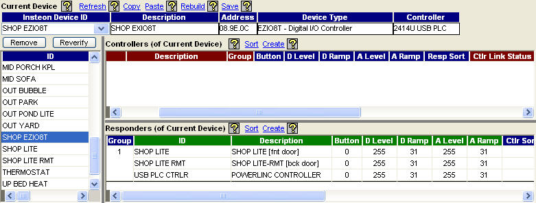

My PLC/EZIO8T Links are set up as . . .
and the Insteon traffic I see upon Door Close (which is what my Trigger is trying to sense) is

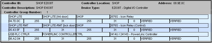

I just tried linking the 8T/PLC by putting PH in Discover Mode and using the SET button on the 8T. PH reported the device discovered but advised it was not added (I'm assuming since I already had used PH to link the PLC to 8t and 8T to PLC.
Everything looks OK to me in the Insteon Groups area.
I then changed the Trigger to be "On Device Change" and captured the data stream showing the 8T action on door open, and then door close.
This time my test (DWN TABLE) light did come on.

Posted: July 31 2008 at 08:26 | IP Logged Quote jbbtex
Gadget -
Are you sure that you have set the EZIO's Input 1 to correspond to the EZIO's Group 1? On my EZIO2x4, the Inputs are factory set to Group 0. I had to use the Simple Home Net Utility to set Input 1 to the EZIO group I wanted.

Posted: July 31 2008 at 09:14 | IP Logged Quote GadgetGuy
Roger that. Here is my setup
BTW - the reason there are leading zeros in the data streams above posted is that these are from my Insteon Thermostat.
The STAT is defined as a device type but never used as such since it is subsequently defined as a Virtual Analog device and used in that mode for status and control. This seems to make things "unhappy" with regard to Insteon traffic, but I'm not sure what to do about it. Device 0E.60.36 is the STAT.
PS - thanks for the data stream labels. It was very informative for me.
What was interersting about them is that the final two Transmit (TX) messages were to the DWN TABLE light (01.63.E9 my test light) and were the PH Trigger response to the 10th data stream line up from the bottom of the post above
   [RX   RECEIVEINSTEONRAW=02 08 9E 0C 00 00 01 CF 13 00 GROUP OFF ]
This Command x13 out from the EZIO8T is to turn its linked lights off and is a Group Command followed by a Group Cleanup to 04.7D.0C (the linked shop light).
Yet these very same data stream elements do not seem to serve as Triggers in PH. At least I haven't been able to trigger on them, only a "Device Change" type trigger.
