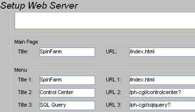

Accordingly I set up the PH server as:
Thinking that if I set the "Main" page to my index.html that is what PH would open as a Home page. Instead I always get the default "/ph-cgi/main" page.
Is it possible to do what I want?

Unfortunately, in the current version this will not work. Ive gone ahead and modified the webserver so that in the next beta, it will.
The way it currently works, if you don't specifically specify the file and only use the form of http://myurl, then PH will first check for the presence of index.psp, followed by index.htm and if neither of those are found, will then give you the default /ph-cgi/main. Ive changed the next beta so that it will now first check index.psp, index.asp, index.html, and last index.htm.
In the meantime, to make it work (and keeping with current security settings, etc.), make an index.htm file with the following code:
<SCRIPT>location.replace("/index.html")</SCRIPT> |
and change the Main page and Menu URL 1 to point to index.htm. This should give you the desired results until the next beta.
