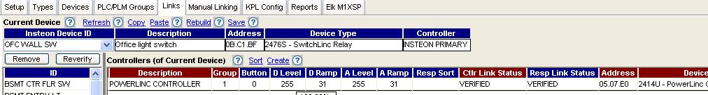

Posted: November 10 2008 at 09:51 | IP Logged Quote BeachBum
If you go to Insteon Explorer under tab Links and select Wall Sw is the PLC listed in the Controllers window?
ibscas
Joined: October 18 2008
Posts: 46
Posted: November 10 2008 at 10:10 | IP Logged Quote ibscas
It wasn't, but I added it as the controller. Still didn't fire the trigger.
