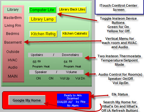

At first I thought there would have to be a separate Apple Application for PH. Then I thought I would have to write special PSP pages for the browser. But neither of those are necessary. The apple browser (Safari) is all that is necessary. I created iTouch specific screens in the control center and they worked perfectly. Here is one of my screens:
The screen refreshes after each press and since I built each button as a toggle with a color change the button color changes to let you know that the device is on or off in real time. The only thing that can't be shown in real time is if someone at home turns a light on or off manually. There is no way to push this information through the browser to the Control Center screen. So I added a "Google My Home" button. This is really a refresh button that checks the status of all the devices and then properly reflects their status on the itouch. This only takes a couple of seconds and works well.

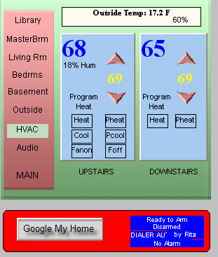

Here's a screen for my HVAC.

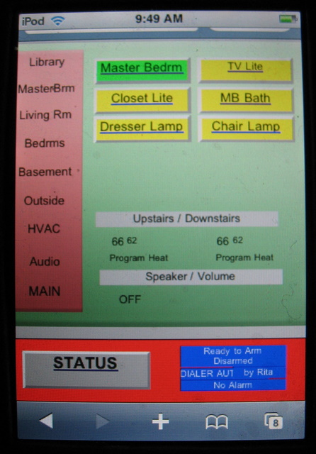

Here's a lousy photo of another screen on the actual iTouch.

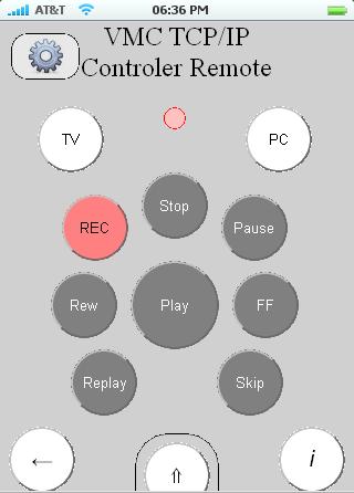

For an example look at my Media Center Remote for the VMC TCP/IP Controller. It's located here. Load this page in your iphone, click on the gear icon, click the "create" button, and then click on the data URL link. Then save this generated page to your home screen (tip #2).
My remote app is probably not very usefull to you (unless you use Vista Media Center), but it illustrates both of the above tips, and would be pretty easy to modify for power home... I'll be porting my pages over as soon as I decide what they should look like on the Touch.
Edit: Here's a screen shot (Taken from a simulator):
