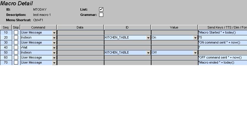

Use PowerHome Explorer, click on Macros, right click in large white space on the right, select Insert, enter the macro ID MTODAY (arbitrary ID) and free form description, click on small box to left of macro ID, enter the macro information in the following screen capture and press PF5 to save macro. Enter the macro ID in the Macro/Formula field in the upper left section of the main Powerhome window and click on Run. The user message is displayed in the event log, the last line of which is displayed at the bottom of the main Powerhome window.

One question. My macro works fine, except when I watch the status bar at the bottom of PH, when it goes to the step to turn the light off it pops up a red "syntax error" warning for a split second and then it goes thru with the command. Do I have something formatted wrong in the below code? Thanks.
Posted: February 07 2009 at 15:12 | IP Logged
Congratulations on your success and I think you found a PowerHome bug. I coded the same macro and see the same situation. The error is coming from the analysis of the Insteon Off Macro line. Because the Off command does work here, I'm guessing that PH is looking at the Send Keys field content even though the Off command does not allow anything to be entered in that field. Dave generally looks at the forum entries and will fix this in time. Since it has no adverse affect on the actual events coded in the Macro, I would ignore it and assume Dave will eventually fix it. There is an email address for PH support which you can use to insure PH is aware of the symptom.
