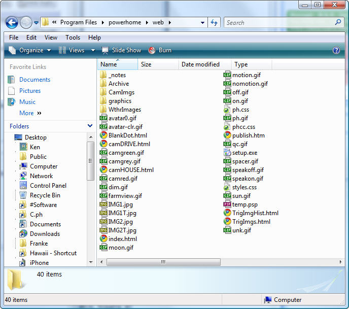

I think I have discovered a bug. When I put my executable in the "web" folder of PH then the ph_run() function works, but if the executable is one layer deeper within a folder in the web folder then it either crashes PH or the executable doesn't run even thought PH gives me a "successful" return code from the ph_run() operation.
Specificallly if the executable is located in CamImgs or WthrImages then the ph_run() effort fails, but if I move the exe to the 'web' folder itself, then things run and do not crash PH in the one case.
It appears that the ph_run() command cannot parse the extra folder depth in the path name. Thus:
ph_run("C:\Program Files\powerhome\web\MovImgs.exe") works,
but
ph_run("C:\Program Files\powerhome\web\CamImgs\MovImgs.exe") does not.
