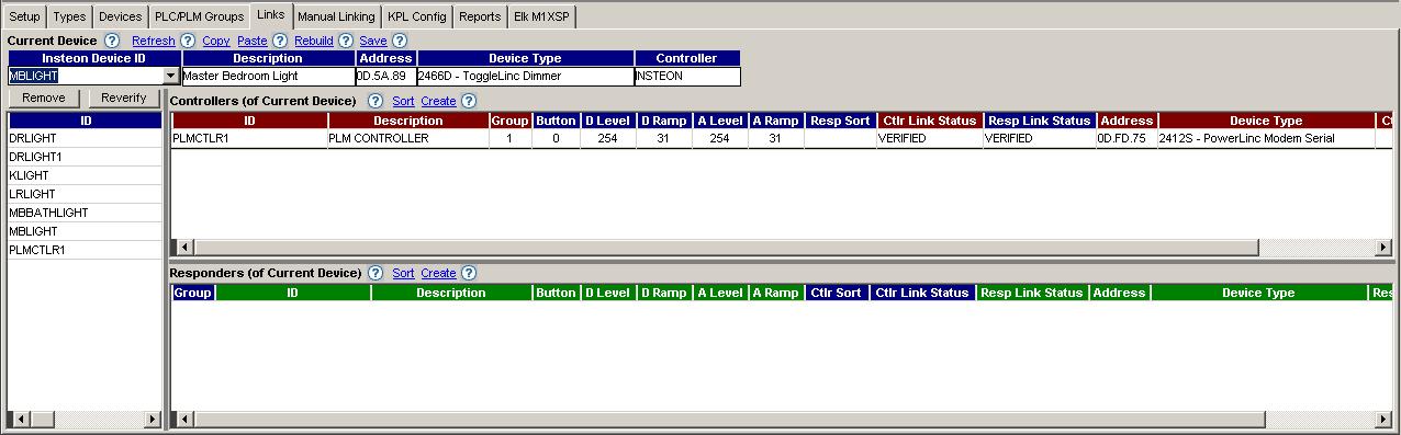

If the trigger id number = the group number (found in insteon explorer\links\responders\group)and there is no number what should I use? See photo.

What are you trying to trigger from? If it is the MBLIGHT turning ON, Trigger type would be Insteon Group IN, Trigger ID would be MBLIGHT, the Trigger ID number would be 1. Generally basic Insteon switches, ToggleLincs, SwitchLincs, ICON switchs, and so on, use Group 1. KPL group numbers are the same as the button number.
