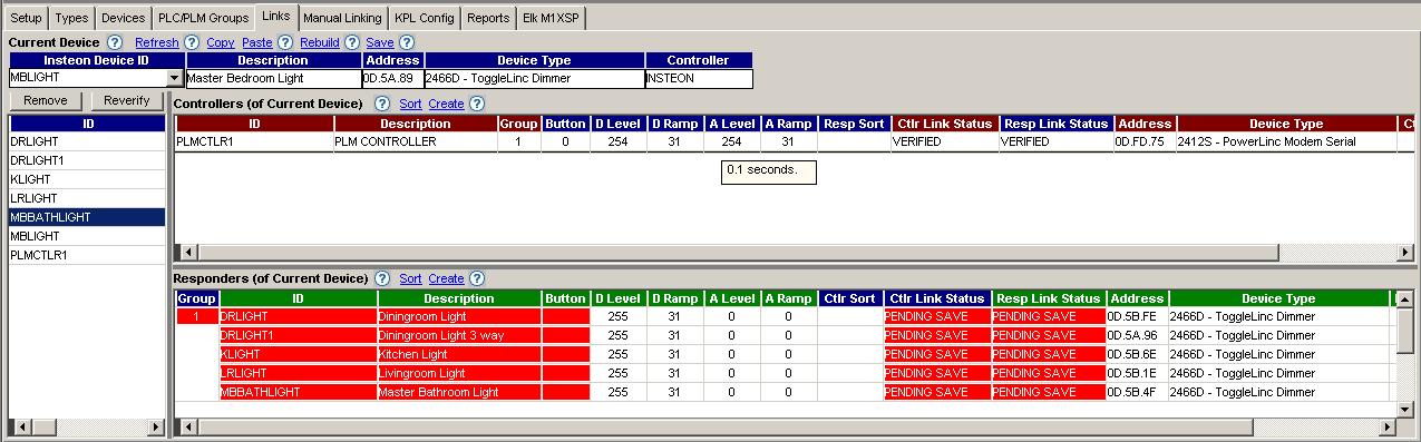

You directed PH to make DRLIGHT, DRLIGHT1, KLIGHT, LRLIGHT, and MBBATHLIGHT Responders of the MBLIGHT switch. The result when taken to its completion is that anytime you turn on/off MBLIGHT, the 5 responders will follow. Does not seem logical but if that is what you want, click on Save and then be sure the Enable Pending box is checked. PH will schedule creation of the links necessary to accomplish the definitions. After the links are created, click on Refresh to update the Link Status columns with the results of the link creation process.
