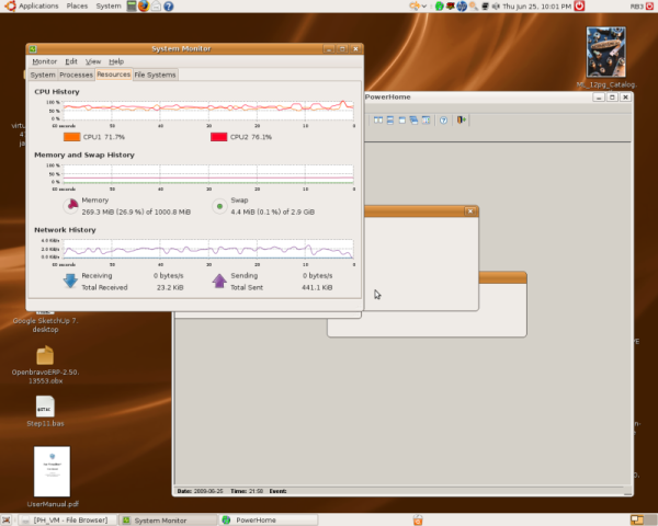

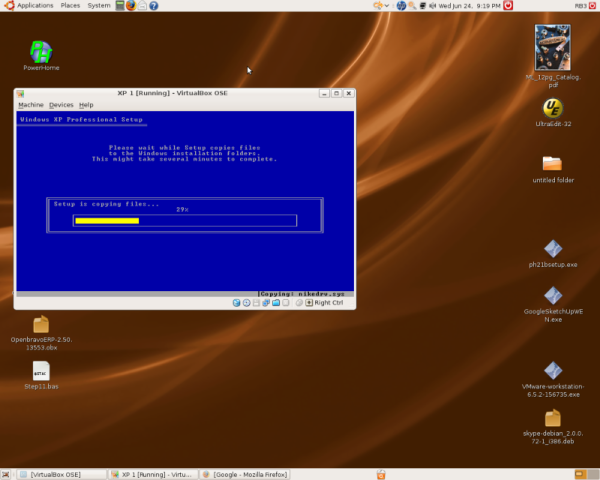

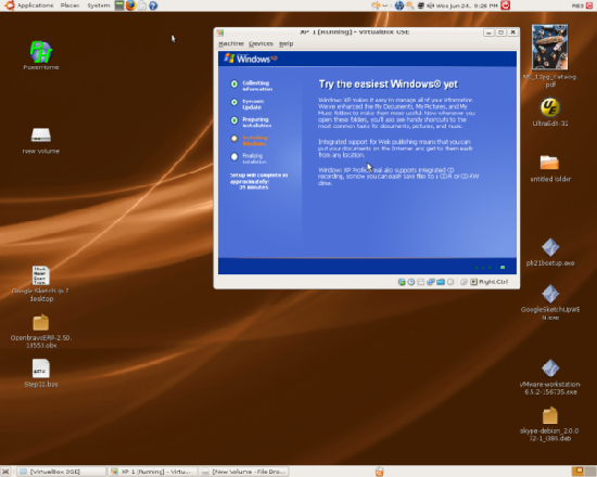

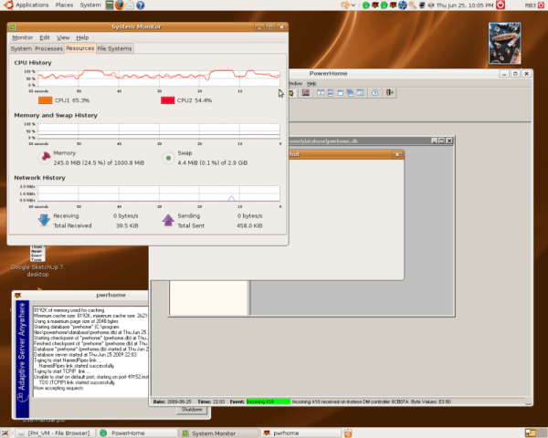

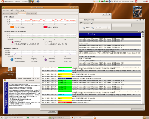

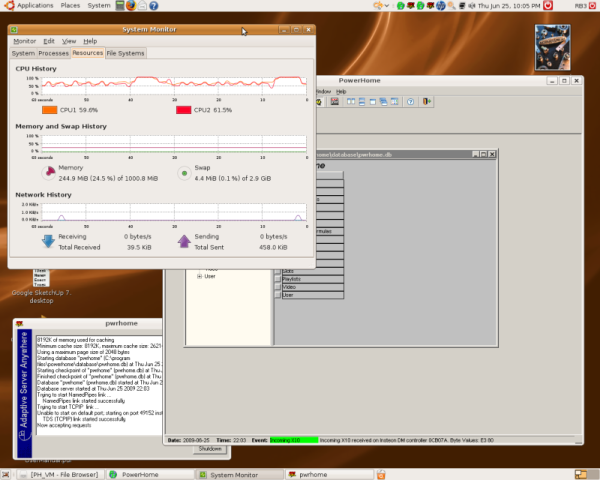

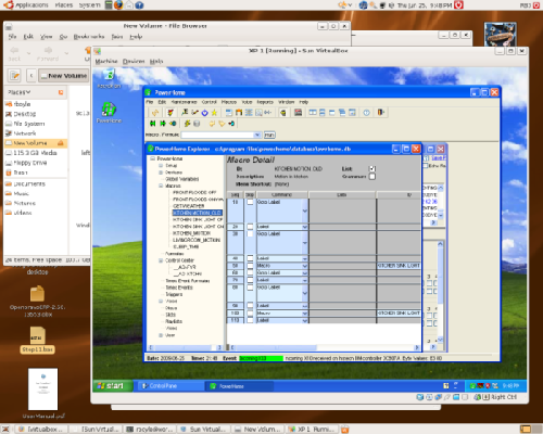

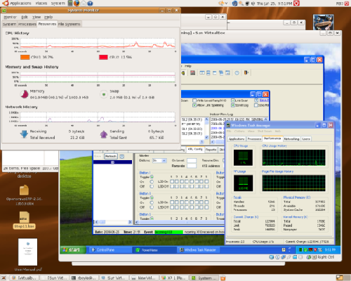

Posted: June 25 2009 at 22:55 | IP Logged Quote rboyleiii
So far, running PH on Wine is very sluggish, there always seems to be waiting periods, it seems to be related to the the amount of database access needed. I have had it stop responding for several minutes on occasion. With PH running on Wine, my system was always using 60% or more of both my CPU's.
The overall performance of Wine running PH left me abandoning the idea for now.
I would like to say that there is still hope for those who want to run a flavor of Linux as their main OS and they own a valid copy of 2000, XP or Vista.
I have been testing an installation of PH with Sun's VirtualBox and I am very happy with the results so far. It uses a lot more of the system memory (500MB vs 250MB, I have 250MB reserved for the XP Virtual Machine, This could be reduced as in task manager it reports it is only using 100MB) but performance is outstanding, not sluggish and just as fast as running on Windows natively. (Well with VB it is natively I guess ;-) )
I have attached screen shots of PH running on both.....
Wine:
VirtualBox:
Edited by rboyleiii - June 26 2009 at 08:59
