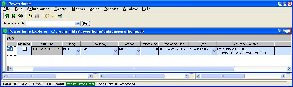

Timed Event Setup:
Not disabled
Start Time: (set 2 minutes ahead of current time for each test)
Timing: Exact
Frequency: Daily
Offset: None
Offset Amount: 0
Reference Time: (set 2 minutes ahead of current time for each test) Here is where I set the time.
Type: Raw Formula
     I also tried Send Keys and Device Control.
ID/Keys/Formula:
PH_RUNSCRIPT_0(0, "C:\PHScripts\Halltest-0.vbs","")
Boolean: 0

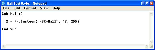

HALLTEST-0.VBS:
Sub Main()
X = PH.INSTEON("XBR-HALL", 17, 255)
End Sub

In the event log I get a green HT1 executed entry.
Still no light comes on.
I attached a snapshot of the entry and the VBS, since a picture can reveal more. (you can see the green event log entry on the bottom).
