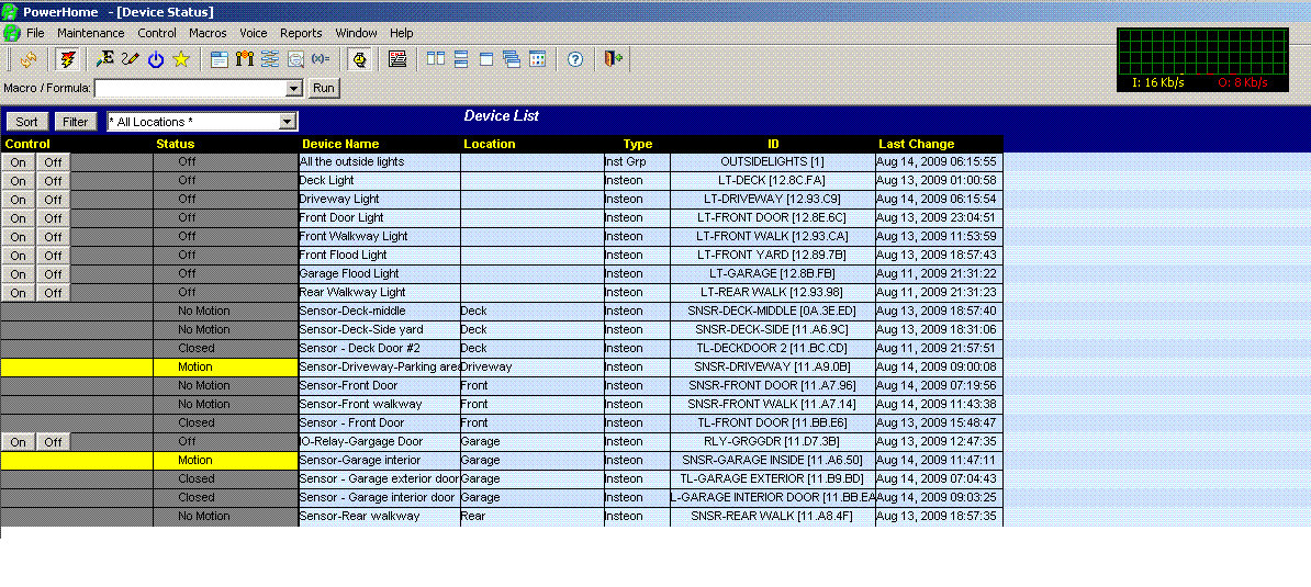

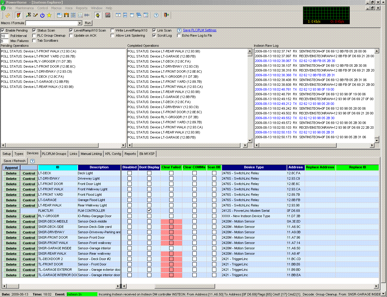

Lots of great data but no specific question.  The red shaded Motion Sensor entries are the result of not being able to communicate with the motion sensor.  For battery operated devices, they must be in link mode before they will communicate to extend battery life.  In the case of the motion sensors they do not support Peek/Poke commands so they cannot have the link database read or written even if in link mode.  The TriggerLinc is also a battery device so the red shaded column may be because they were not put into link mode before PH tried to communicate with them.   I do not know if a TriggerLinc supports Peek/Poke.

Ahh, the Access Points.  I have 2, and they are associated with outlets on the left and right side of my breaker box.  All motion sensors are within range.  No powerstrips or UPS's in use.
 I thought I could join the devices just by manually adding the addresses.  I'll hit the set button on each,  get them linked, and report back on next challenge.

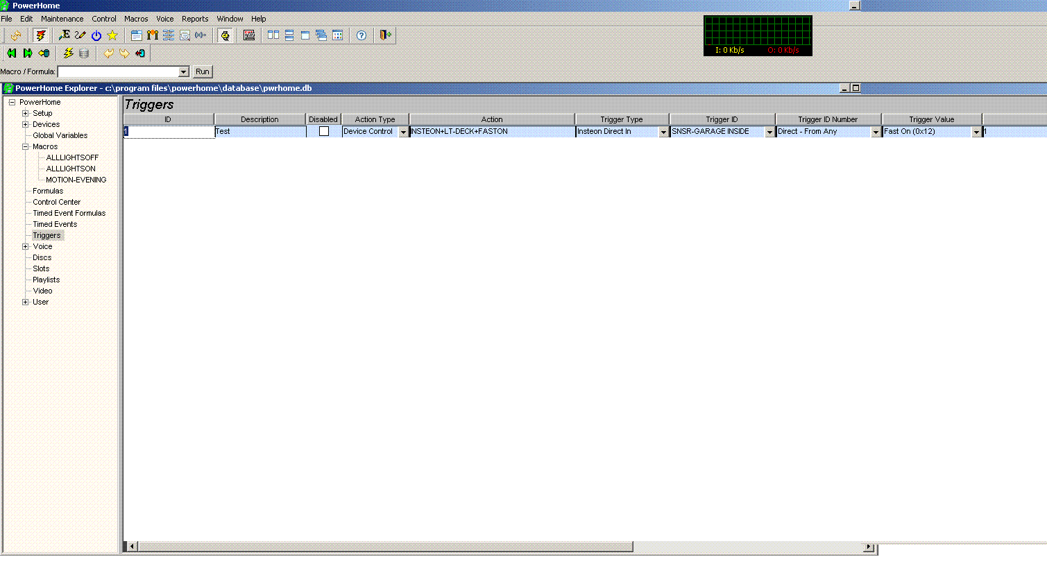

The following link will get you to a trigger definition for a motion sensor.
 Link To Motion Sensor Trigger Definition
 I would suggest the trigger action be the invocation of a Macro and issue the Insteon commands you want to happen from the Macro.  There are potential problems with issuing Insteon commands directly from a Trigger that do not exist when issued from a Macro that is started from a Trigger.

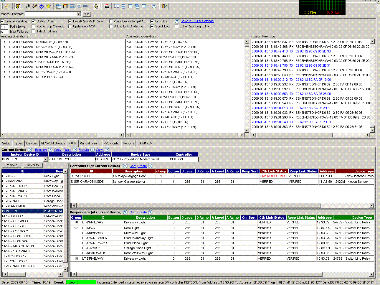

John unless I’m missing something I don’t think the devices are linked to the PLM. You have to put the device in linking mode by pressing the setup button then you have 4 minutes to go to the PLM and press it’s setup button until the other device stops blinking.
  Joined: March 26 2008 Location: United States
           | Posted: August 14 2009 at 13:36 | IP Logged
Pete,   I think he did a successful "Manual Linking" tab operation because the Device Status screen capture shows the motion sensor ON.  I could be wrong but I don't think it would show ON unless the PLM has taken the motion Group 1 message and passed it on to PowerHome. The only trigger definition that is posted as a screen capture specifies a Fast On command as the trigger value and that does not work because the motion sensor does not issue a Fast On.

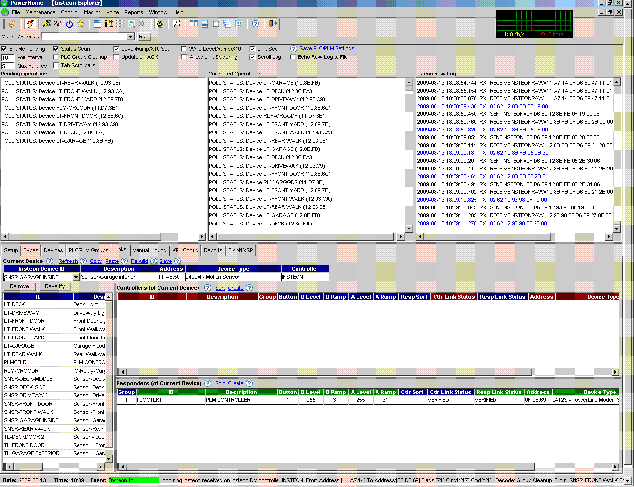

Manually added PLM to the motion sensor (twice) the the motion sensor activity is not being registered in Device Status.  The set button will light up the Status screen, but motion is a bust.  Feels like a step backwards.

Although I think using the “Manaul Linking” tab is easier, using the SET button on the responder should work and that technique is all hardware.  No PowerHome involved.  If pressing the Set button on the motion sensor does not show up in the Event Log or the Insteon Raw Log windows, hardware did not create the link.
 If you do decide to come back to Powerhome, I would use the “Manual Linking” tab to create the link between the motion sensor and the PowerHome PLM.  Then correct the errors in the trigger definition, using the information in the other post, set the trigger to invoke a macro and issue the Insteon commands you want executed on a motion detection in the macro.

John, going back to your earlier post, if your trigger is still the same try this. Trigger Type  - Insteon Group In, Trigger ID Number – 1, Trigger Value – On(0x11).
