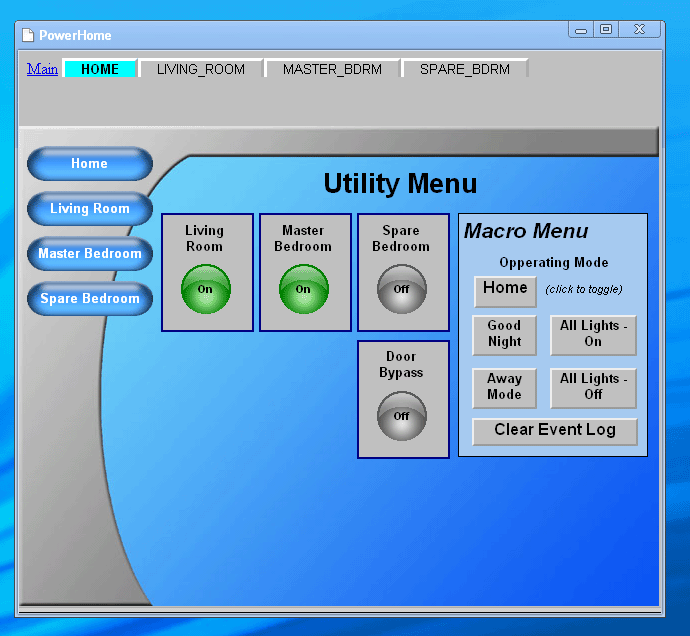

I would like to change a graffic in CC based on device status. I was going to use a device stauts change trigger to switch the CC graffic on. I have had issues understanding how functions are written. I did figure out how to create a "Toggle" global text box but can't figure out how to form this statement:
ph_setccobjgraphic ("5TEST","OBJ_1","C:\Program Files\powerhome\web\graphics\buttons\b5red_260.gif","C:\Prog ram Files\powerhome\web\graphics\buttons\b5red_260.gif",1)
Any help would be great....

Thanks to all for your help. I was able to create a single button CC page where buttons and text change based on status. Button commands also toggle based on status. Now I need to figure out how to push that to the web center pages so you don't need to do a refresh to see the changes.
